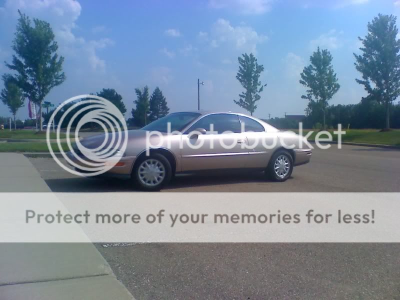

| Cleaned her up for the first time in a while. She looked sexy sittin there, so I thought I'd take a pic. I really need to get a real camera for high-res pics. | |

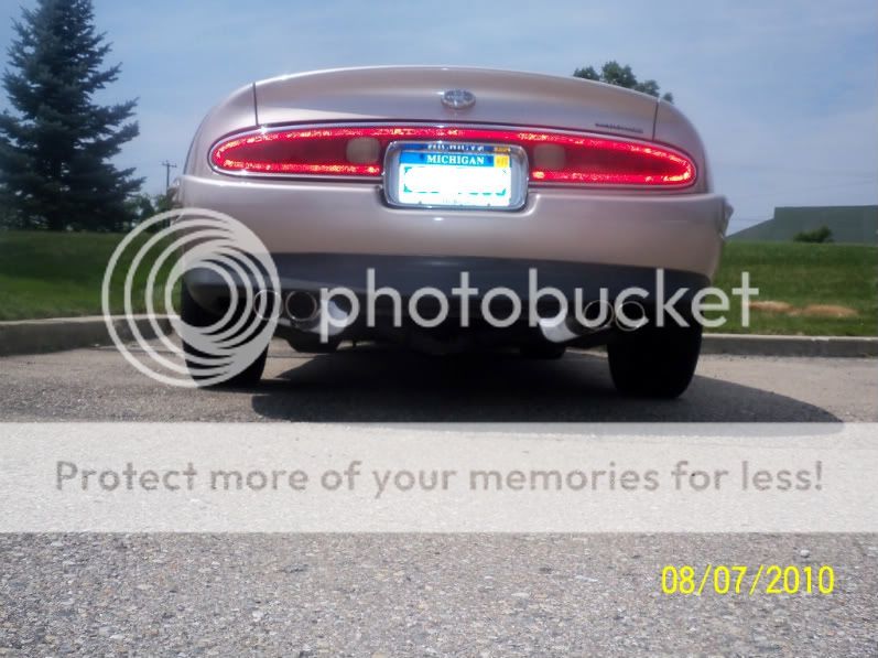

| So, I had to get a new exhaust. My DynoMax Super Turbo's I had decided to rust through . I bought 2 SS Pypes M80's with 3" inlet and outlet (they're tubes) to mount right after the DP. These are advertised as mufflers, not resonators. They lie.......bastards And after looking at this pic, it appears I'm missing a clamp?! It was ridiculously stupid f*@king loud, and I was embarrassed to drive it. Now, I like a good sounding loud exhaust, but these things are ridiculous. They do sound cool by themselves, just about 50dB too loud. I couldn't hear the S/C, I couldn't hear the radio......So, I ended up ordering 2 DynoMax 2 chamber welded mufflers the next day. I had to drive the stupid thing for 2 days until they arrived. Made a trip back to the Exhaust shop. The guy that did it met me in the parking lot before I could make it to the door. The first words out of his mouth were "Change of plans"?....with a little grin. This is what we ended up with. I missed a spot cleaning the tips on the left inner pipe..... It sounds pretty cool IMO. It's not that loud until you hammer the gas. I left the other mufflers on there, so I have 4 total lol. It's still louder than I thought it would be, but whatever.....The cruising drone is less than my old mufflers, which is surprising. Apparently, even 4 performance mufflers can't tame the raspiness this 3800 emits. It's different, but that may be why I like it.... I actually got to make a video for 'ya. The woman let me borrow the camera that I bought her All that hissing you hear is a fountain in the pond to the left. I took this vid in a subdivision that has 3 occupied homes (8,000 sq ft +) and 7 not finished. It's been like that for 4 years..... | |

btw, did you remove the rez? and what are the part #s for the mufflers? There is no factory anything left in my exhaust, including no cat. The P/N for the SS M80's is 958-MVR203S from Jegs.com The P/N for the DynoMax mufflers is 289-17655 also from Jegs.com As stated above, all 4 mufflers are still on the car. I suppose you could use just one of the M80's as a resonator, but I bought 2 thinking they'd be quiet. So I just left 'em on the car. | |

| Actually, it's not heavy at all. Those SS M80's are very light and so are the Aluminized DynoMax Muffs. It's now 3" all the way until the end of the backseat, where we used the reducer from 3" to 2-1/2" that came with the headers. Then it goes to the Y-pipe where it splits into 2-1/4" pipes and out the mufflers. The guy that did the install did a great job. Even though those tips are up in the bumper (notice the cutouts), they don't touch. The "end" of the system is rock solid tight with steel hangers dampened by rubber inserts. Before, I could feel the exhaust sway when taking corners. Now, it doesn't move..... Expensive.....lol. I think I ended up spending a grand total of around $400. Let's add this up.... Headers (with wrap and everything) = $500 New Exhaust = $400 LOLOLOL Didn't realize I have damn near $1000 into the exhaust No wonder I'm broke | |
