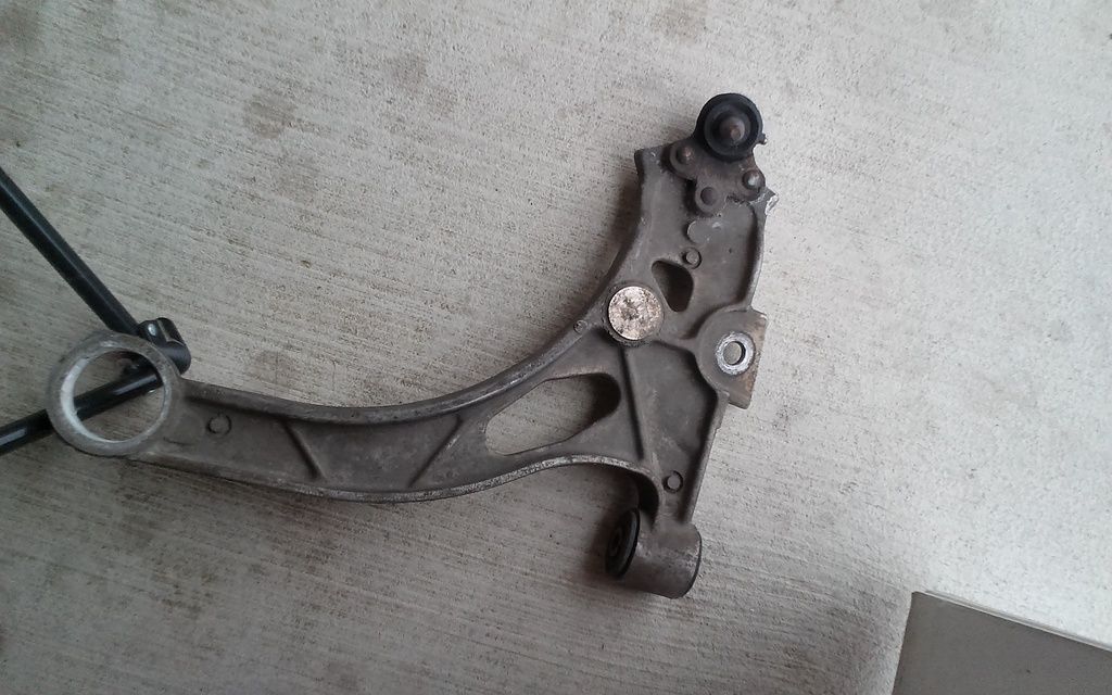

PostSubject: Front lower control arm from my 97 rivi   FAQ: Lower Control Arms & Bushings 1995/1996/1997/1998/1999 - Page 7 EmptyFri Apr 17, 2015 3:46 pm
Could anyone here tell me where/what year this control arm is from? FAQ: Lower Control Arms & Bushings 1995/1996/1997/1998/1999 - Page 7 <a href=FAQ: Lower Control Arms & Bushings 1995/1996/1997/1998/1999 - Page 7 0417151437_zpslpavseed" />

'97. Like I said one vertical and one horizontal bushing just like 95/96 but aluminum.
What is the I.D. on that vertical bushing recess?

I tried and tried everytime I looked for the 97 one they were totally different..

I will check. one sec

Yeah they show two horizontal bushings. I guess they were early 97s. As some 97 Auroras have the one vertical on horizontal and others have the two horizontal.
If I can find two of those control arms, I will find poly bushings haha.

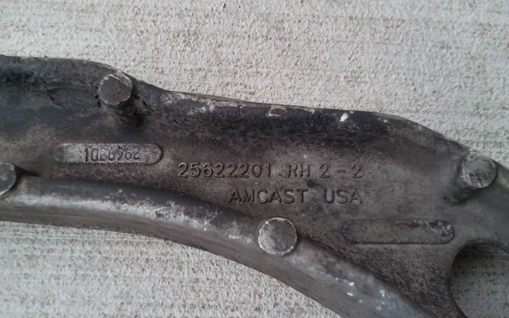

Sorry for crappy quality my tablet camera sucks..FAQ: Lower Control Arms & Bushings 1995/1996/1997/1998/1999 - Page 7 <a href=FAQ: Lower Control Arms & Bushings 1995/1996/1997/1998/1999 - Page 7 0417151458_zps5ve7vyyz" />

Lol. I just need that bushing and I've had no luck locating it anywhere..I had my car in the shop for 3 days and eventually had to settle for a crappy stamped metal one from a 91 buick. I just need too know where the hell these come from. lol

would love to get my hands on 2 of those complete arms like that. my 96's bushing are shot and i cant find a complete arm anywhere.
Tried both those stamped numbers in google and got nada.
Too bad rockauto doesnt have pictures of the complete arms to tell if they are infact different from the 98+ arms on all 97 rivs.

Exactly Mr. Riviera. If he can give me accurate measurements I will scour for some poly replacement bushings. I am sure I can find a pair of junk ones somewhere to press new in.
I have came up short searching for them new. NLA from GM. The mevotech you link are two horizontal bushing from a google image search. I saw them earlier and searched. I found a thread where someone used an audi bushing machined down 0.5mm and pressed into the front mount here on this forum.
