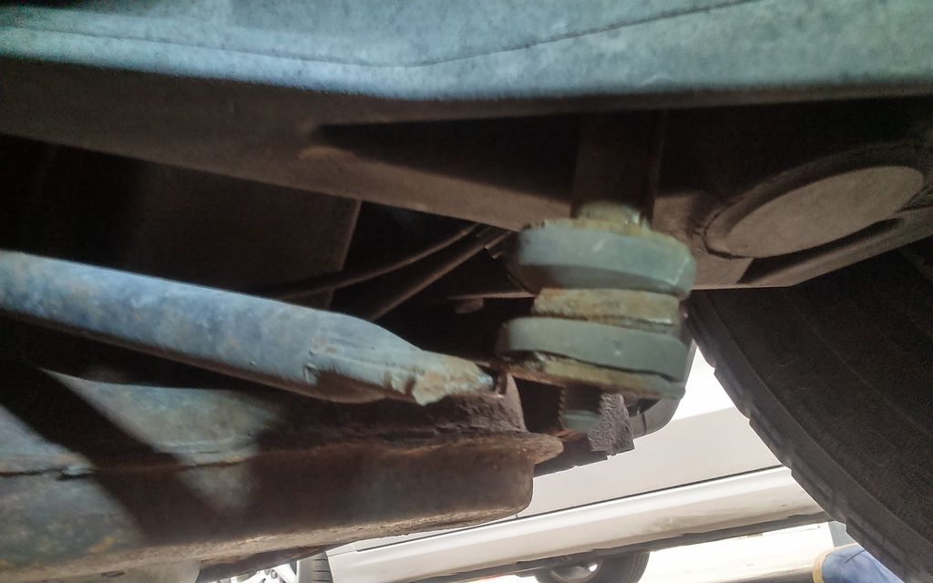

Lol..Thank for the info and help! I broke my passenger one doing 90 mph around a bend...stupid me.

You broke the end link or the sway bar?

The sway bar broke from the end link.

Here. Please excuse my rust.. FAQ: Lower Control Arms & Bushings 1995/1996/1997/1998/1999 - Page 8 <a href=FAQ: Lower Control Arms & Bushings 1995/1996/1997/1998/1999 - Page 8 0417151319a_zpswn8uw4jt" />

Thats actually kind of impressive. I'm not sure I've personally seen a sway bar snap BEFORE an end link lol.

That's what happens with rust on the undercarriage and from 90 mph around a turn causing overSteer. Lol.
