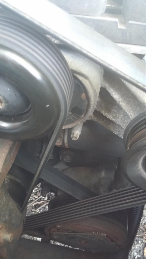

Today I changed the S/C belt tensioner pulley hoping that was the source of the noise I could hear from under the hood. Installation was easy, but I never realized until rereading the OP that there were marks that had to be lined up. What exactly are they supposed to be lined up with? I can't really tell in the pictures, or on my car.
Write-Up: Replacing Belts and Pulleys - Page 11 20140916_174225_zpspleyild1
The belt kind of moves side-to-side on the S/C belt tensioner pulley. It also kind of "jumps". I don't literally mean jumps, but you can see it moving up and down too. Maybe I need a new belt too? I'm not sure.
Post Count : 18369
Write-Up: Replacing Belts and Pulleys - Page 11 Empty
PostSubject: Re: Write-Up: Replacing Belts and Pulleys   Write-Up: Replacing Belts and Pulleys - Page 11 EmptyTue Sep 16, 2014 6:18 pm
Make sure you have the belt aligned correctly with the bottom grooves of the crank pulley.

Aside from part of the belt not being in one of the grooves, I don't think I know what else to look for. I had this thought that maybe It's because of the new S/C belt tensioner pulley being new. The old one had the black worn off from where the belt had been riding on, but the new pulley doesn't. That's probably a really ignorant thought, but that's all I can think of. I don't know how that would cause the side-to-side and up and down action of the belt.
