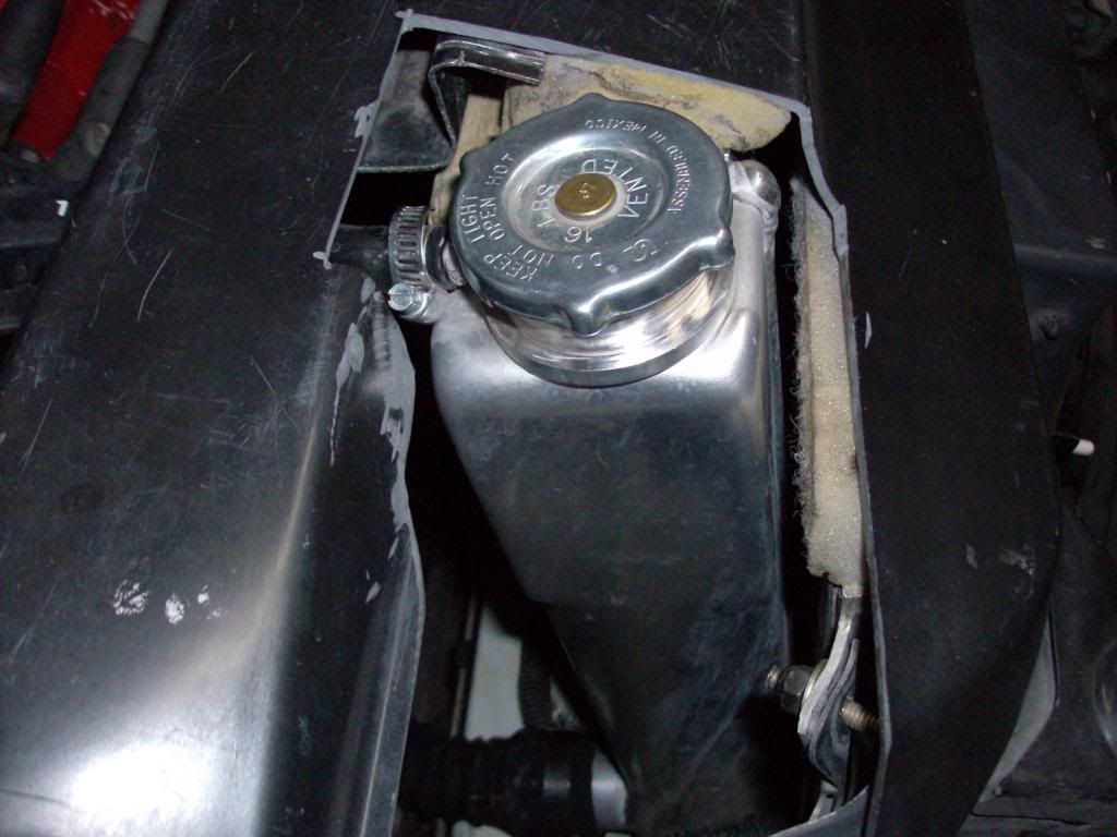

| This is what I got.has everything except the coolant level sensor. works great. if youre running stock you have no idea what youre missing.with this rad underhood temps are way down
http://www.jegs.com/i/JEGS-Performance-Products/555/52009/10002/-1?parentProductId=752961
took very little modification to install.looks really cool too! I am only using 1 OEM fan and thats plenty to keep the engine cool.I do have 1 of these on order.come summer time Ill need the CFMs
http://www.jegs.com/i/JEGS-Performance-Products/555/52115/10002/-1?parentProductId=1014845
chillin | |
| Subject: Re: Write-Up: Radiator Replacement Sat Mar 16, 2013 2:09 pm | |
| That JEGS unit looks nice, and priced right. I like having the coolant level sensor (saved me once), but I wouldn't miss the cracking plastic hose fitting on the OEM one bit. I'd like to find an all metal option with the sensor, or modify one like this to accept it.
Back to the ZZP unit, for $300, you could almost buy a used PCM tuning package and program your fans to keep the coolant very close to 180º-185º even in summer. I find it really hard to get temps much above 185º when driving. Even at the road course last year, well below 200º most of the time, after a dozen 2-mile laps. If that's all I used the car for, maybe the ZZP unit would make more sense. _________________ '05 GTO 6.0L • 6-spd • 95k miles • 0-60: 4.8s • 16.9 avg MPG • Nelson Ledges Lap: 1:26'95 Celica GT 2.2L • 5-spd • 165k miles • 0-60: yes'98 SC Riviera • 281k miles • 298 HP/370 TQ • 0-60: 5.79s • ET: 13.97 @ 99.28 • 4087 lb • 20.1 avg MPG • Nelson Ledges Lap: 1:30 3.4" pulley • AL104 plugs • 180º t-stat • FWI w/K&N • 1.9:1 rockers • OR pushrods • LS6 valve springs • SLP headers • ZZP fuel rails KYB GR2 struts • MaxAir shocks • Addco sway bars • UMI bushings • GM STB • Enkei 18" EV5s w/ Dunlop DZ101s • F-body calipers EBC bluestuff/Hawk HP plus • SS lines • Brembo slotted discs • DHP tuned • Aeroforce • Hidden Hitch^^^ SOLD ^^^ '70 Ninety-Eight Holiday Coupe 455cid • 116k miles^^^ SOLD ^^^ | |
| Subject: Re: Write-Up: Radiator Replacement Sat Mar 16, 2013 2:36 pm | |
| couple pics of installed rad.I know it looks a little hacked.Ill address the look of everything when I can.but its super strong installed and done move at all.I even used the OEM rubber blocks to isolate the rad.only took a little trimming. my oh so cool Gates Vulco flex hose! The installation of the Jegs rad nessecitates special hose.a 1 1/4 x 1 1/2 upper rad hose & a 1 1/2 x 1 3/4 lower. with these hoses ,flow is so much straighter.the whole set up imo,takes a lot of stress out of the cooling system. | |
