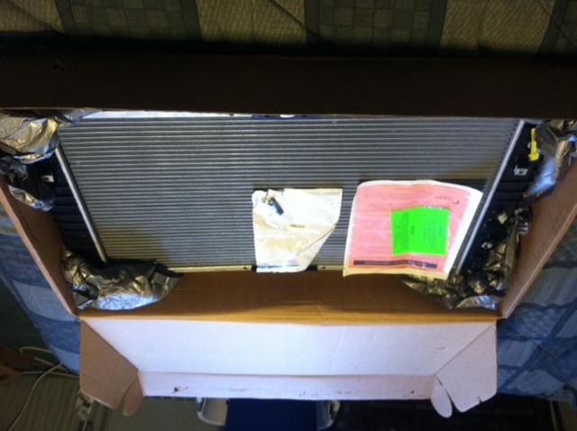

| My radiator also failed a couple days ago on my '95. The problem seems to be coming from just an inch or two below the upper radiator hose, the plastic side seems to have cracked. This is available today, will have to pay more because its a local parts store, but have to get'er running asap now with some money in my account. Will also report back. Murray® Heat Transfer - Radiator Part # 431364 I looked up the unit on Amazon, and the VISTA-PRO came up. Same unit, just a different name on the box? I wonder just how many of our parts are made by the same manufacturer, just marketed under different labels, and of course, prices? | |

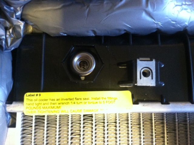

| Well, got the job done today. Took me 4 hours working slowly and carefully so as not to break anything. We all know how that can happen. I bought the Spectra Premium Radiator from Rockauto. Was 141.00 to my door with the discount code. Paperwork that came with the radiator said Vista Pro, so Sprectra must be the same manufacturer. I am happy to report that it was indeed a drop in installation, and 45.00 cheaper than the AC Delco unit. The only problem I had was the 2 center bolts that hold both fans to the radiator. The replacement bolts furnished were no where near long enough. The stock radiator has 2 clip nuts that receive self threading bolts. The Spectra Radiator had a different arrangement using 2 square, threaded nuts that slid into a plastic receiver, so I could not use the clip nuts. What I did was use the stock self threading bolts, some anti seize, and I slowly rethreaded those 2 square nuts that were provided. Worked just fine. This write up was a HUGE help though(Thanks Scott). Had some trouble getting to the fan electrical plugs. You kind of have to feel around with a small screwdriver for the release clip. Took me a little while, I didn't want to break anything. The Spectra radiator came with the proper transmission inverted flare fittings. Didn't have to transfer any fittings from my old radiator. You have to be very careful not to cross thread, and it doesn't take much to seal up. Instructions say 1/4 turn past hand tight, or 5 ft. lbs. Reused the lower hose extension. My hoses looked great, so I didn't replace them. Transferred the low coolant sensor. O rings looked fine, so I smeared some white lube on them and installed the sensor. It didn't leak. _________________ 98 Riviera SC3800 All stock except gutted air box. 1970 Buick GS455 Stage1, TSP built 470BBB, 602HP/589TQ Best MPH, 116.06 MPH, Best ET, 11.54 https://www.youtube.com/watch?v=UHCda-t_Jls https://www.youtube.com/watch?v=sfT2tEO4XcU
