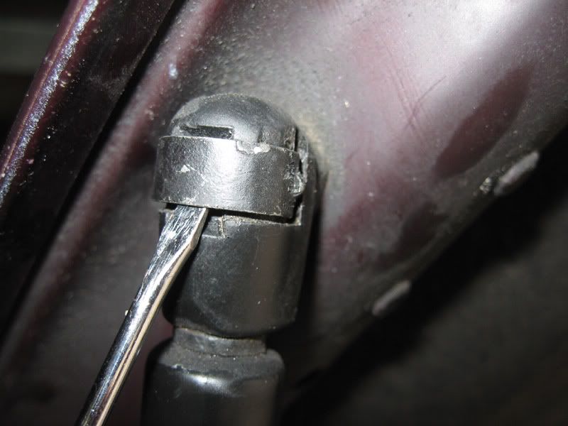

| I like my cover, though I think they modified it on the Series III to allow better airflow thru the alternator...

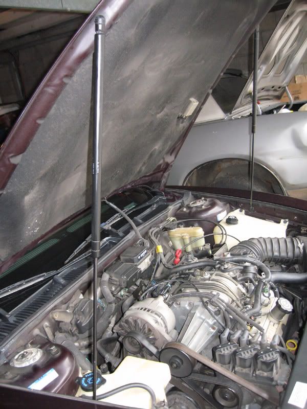

If you want to keep the cover and still access the plugs, what I did when I changed mine was:
- Disengage the passenger-side hood strut from the hood and lay it down in the fender channel. (If your struts are any good, and it's not freezing outside, one should be enough to hold the aluminum hood up - or you can use a broomstick...) - Pull the screws and gently walk the heater-pipes out of the alt-bracket/belt-tensioner, so I could twist the hoses out of the way. - Slide my left arm in to wrench on the plugs. | |

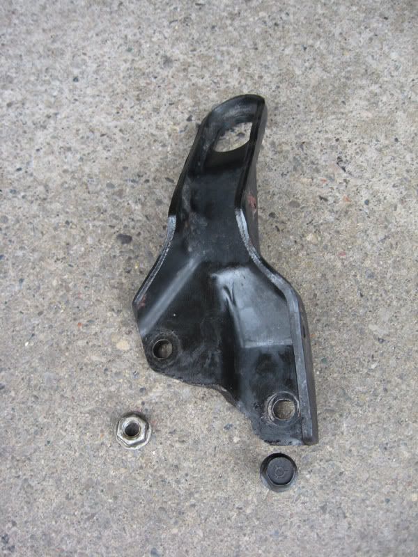

You have mentioned loosening the screws and rotating the heater brackets for better access before. I remember thinking then and now, are there not o-rings in there to be concerned about. On a car that hasn't had those touched or moved with high mileage, isn't there the chance of causing a leak, that could just add some misery to someones day.? If someone has run the factory plugs to near there specified life of 100k miles and didn't move the nipples then and came back say 70k later to do a plug change and saw this recommendation and decided to do it, that would put those o-rings at a near ancient age, don't you think. Now I know in my case having changed them and lubed them I would not worry about taking your advice, but isn't a disclamer in order for someone that may not realize what rotating or disturbing those o-rings could do. Or am I wrong on this point.? I will stand corrected if I'm totally off base. BTW, how the heck are you.? Are these O rings readily available at any parts store, or is it a dealer item? | |

| - BMD wrote:
Are these O rings readily available at any parts store, or is it a dealer item? The dealer (if he's very good with his computer) may be able to find out exactly what size they are before the car is taken apart, but as far as I know they are "plain-old" O-rings... | |

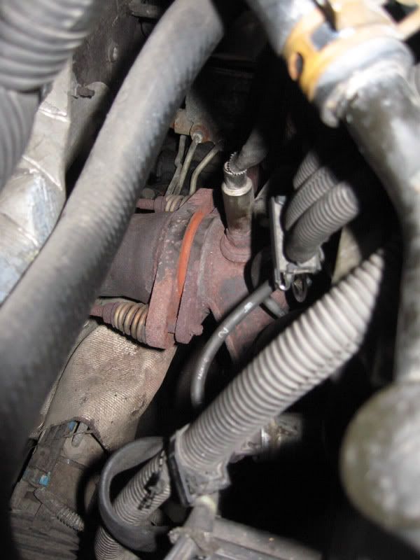

| Subject: Re: Replacing Spark Plugs (Series II SC) Sat Aug 21, 2010 4:06 pm | |

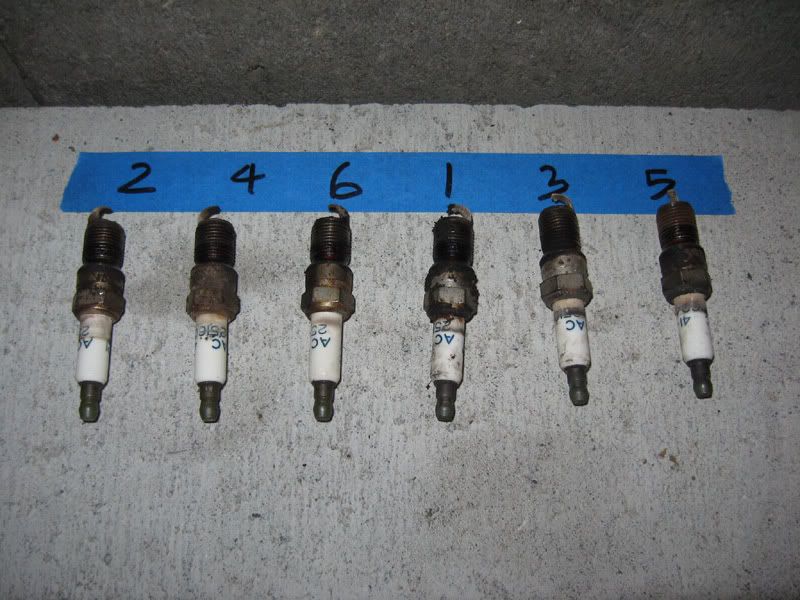

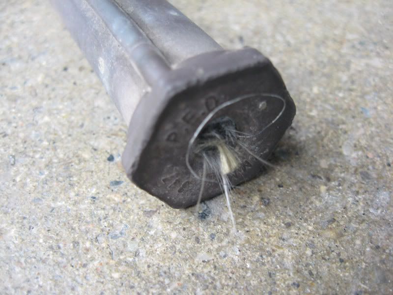

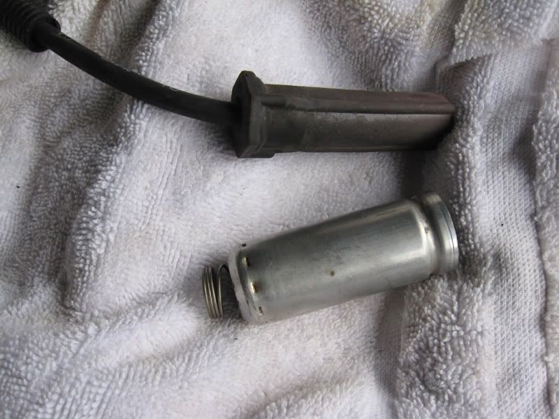

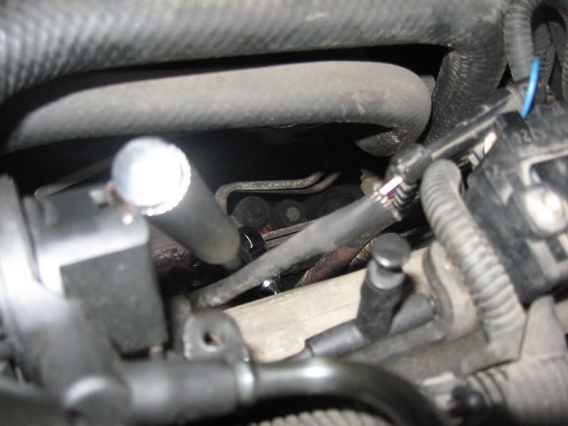

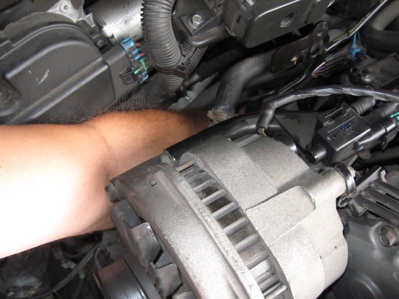

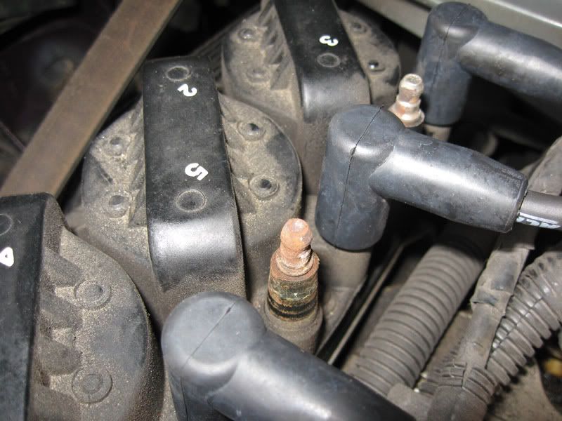

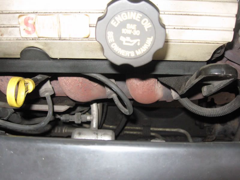

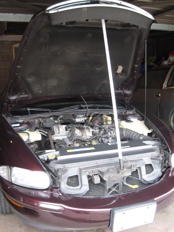

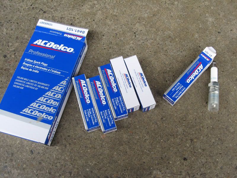

| Well, with all the discussion about changing plugs, I thought I would take some pics of my replacement to provide a visual to all that is being said. I’ve always done my own plugs on my other cars but I never tried it on the Riv, because of the rear plugs. but thanks to all the tips and info here I decided to give it a shot. I used the the recommended plugs and and wires from the dealer, $160 all together. I don’t see how anyone can have any issue with the front three, these literally took less than ten minutes. As recommended by many members here on the site, you need to remove the passenger side strut to get at the rear plugs, by removing this spring loaded clip from the top of the strut, then lay it down along the fender, and support the hood with something, I used a broom stick. Then I removed the engine hoist bracket off, it is held on with a 13mm bolt and a 13mm nut… You can see how much room that creates to get your left arm in there. Now I have a sort of stocky build shall we say, so thats how far I could get my left arm between the heater hose pipes and alternator bracket. It’s a good idea to turn the hose clamps away to keep from knicking your arm, but that alternator bolt kept wedging into my arm anyway . From here I was able to do plugs 2 and 4 easily. I could do plug 6 from here aswell if I squinched my arm a little further in… but I decided to remove the bracket that holds down the engine cover, with it out of the way, I was able to wrench plug six from above with ease. It is held on with two 13mm nuts. Each of the rear plugs have a spring loaded heat shield that must be re-used. As recommended on this site, have the wires ready to go because this is what happened when I twisted and pulled on the plug boot for 4… A couple of terminals on the coil pack had significant corrosion, I lightly sanded them, but I think I might be getting new ones. I lined up each plug to inspect afterwards, they all seem to have the same amount of corrosion, grime and erosion. Anyway, I know none of this is news to most of you, but I enjoy contributing when I can and maybe this will help out some new members. | |

| Subject: Re: Replacing Spark Plugs (Series II SC) Sat Aug 21, 2010 4:20 pm | |
| ^doesnt look like any less room then my park ave... | |
BMD Aficionado
| Subject: Re: Replacing Spark Plugs (Series II SC) Sat Aug 21, 2010 10:26 pm | |
| I don't know what physical characteristics you have Tyler, but it is much easier for me to get my hand back there on my dads ParkAve than on my Riv.

| Nice job BMD. Them wires and plugs were nasty, and I'm surprised to hear that the rusted coils weren't causing more of an issue. I apologize in advance, but I'm going to add something to your process.....
--- Use the silicone grease on the spark plug boots (comes with wire set). This will keep the boots from seizing themselves onto the plug and ripping the wire out next time around.
--- This is not mandatory, but using a little bit of Anti Seize on the plug threads is a good practice. This helps keep the threads clean and free of corrosion. Also aids in removal (the next time).
