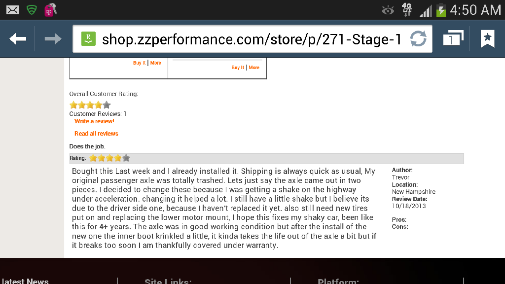

Vibration / Shimmy at Cruising Speed - Page 14 Screenshot_2013-12-14-04-50-24_zpsyynjqniz
After reading zzp site gtp guy says the same thing we have been conjuring up

It very well could be your axles. I wasn't saying that it isn't. Axles will absolutely cause a vibration.
Axles can be bought for around $80 each. The labor on installing said axles should only be about 3 hours TOTAL (1.5 per side)....at least that's what I would charge. Anything more than that is rape.
WARRANTY replacement on a 2005 Grand Prix (same setup) is only .7 of an hour.....
$80 x 2 = ~$160
3.0 Labor + 1.0 diagnosis = 4.0 hours @ $90/hr (estimate) = $360
$360 + $160 = $520 Total
I'd say that you shouldn't pay no more than $600 for both axles to be replaced. I deal with aftermarket parts all the time, and there's no way it should cost you $1000 for axle replacements.
I'm just giving you a heads up. I hate top see people get screwed.

I'll say it isn't - at least until you determine your axles are in as bad as shape!
When I read that ZZP post, it reminded me of what I've seen at our board and other forums: replace parts like CV axles with the false hope it will cure a wheel vibration issue. Sure, it's possible if your axle is about to fall off the car, but not likely if the axle isn't loose. I read that ZZP post and see misdiagnosis, not a cure for vibration issue. There are so many other things wrong with the that guy's car (he even mentions a few of them), I do not believe the axle replacement solved the issue at all, especially since he says the vibration remained after the axle swap.
And the ZZP guy says his axle was "totally trashed", "in two pieces". Well of course it's going to seem like it contributes to the vibration with all that grinding rolling down the road. From the description, it seems like he has neglected so much maintenance - not the best situation to draw solid conclusions from.
