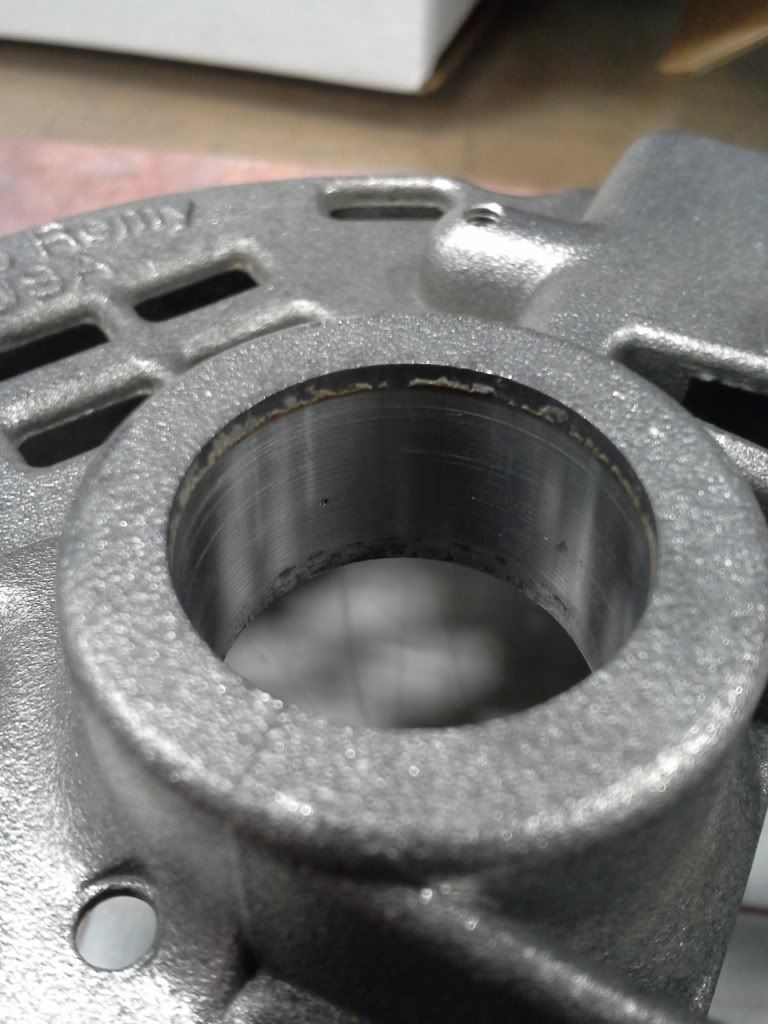

Replacing rear needle bearing on the alternator - just a few tidbits to help but it's totally doable.
I got a replacement alternator from a junk yard to machine the rear case and use on my car and I figured the bearings are cheap, why chance it.
There is a very slight step there you can see so you want to press it out towards the inside of the case.

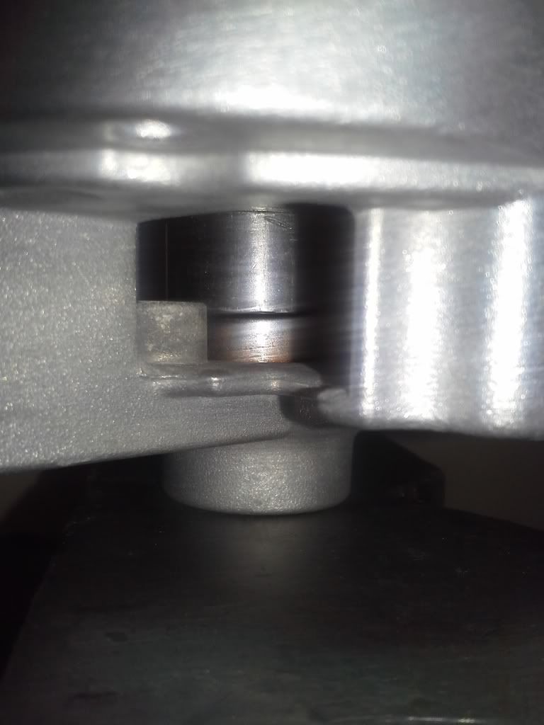

Pressing the new one in I used some anti-seize for good measure. Rest the case down on an even surface right on the back. The area of the case surrounding the bearing sticks out so that's all that need be supported.
not the best pic but this is demonstrating you can kinda look through the cavities of the empty alternator case sideways to make sure the bearing is lined up even so you don't start pressing it cocked.
almost there. At this point I used the old bearing as a spacer to press it the rest of the way because the larger piece of metal I was using ran out of clearance with the inside of the alternator case.

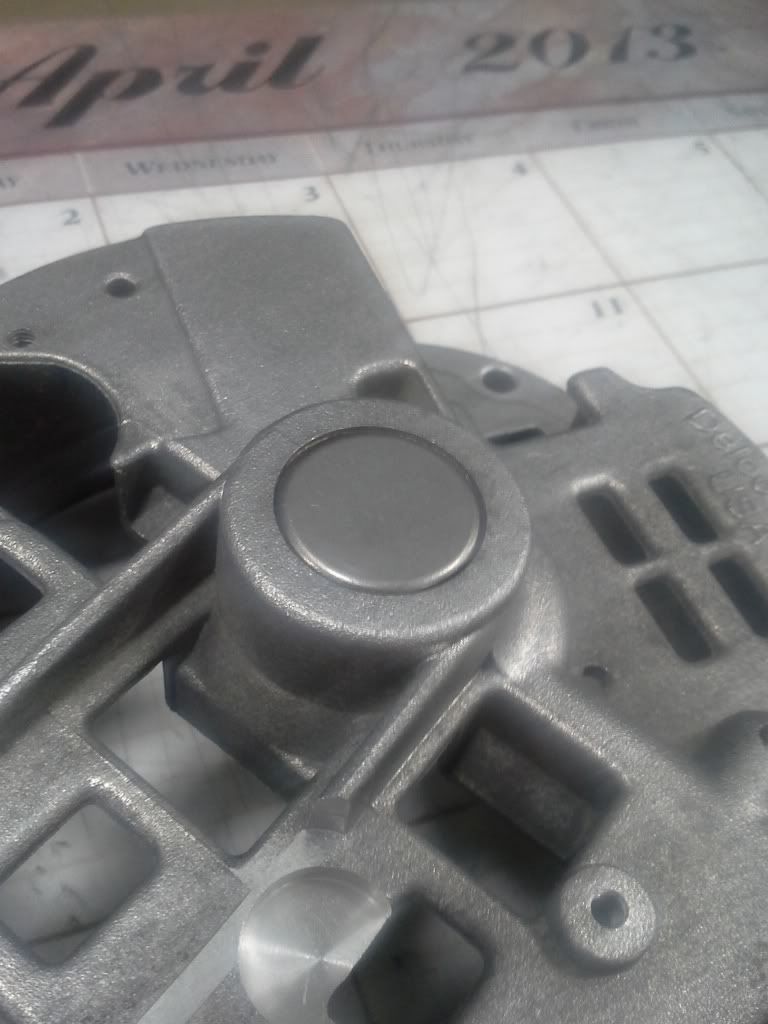

There we go.
Just going flush to the outside surface of the alternator case and you're done! Stupid easy.
