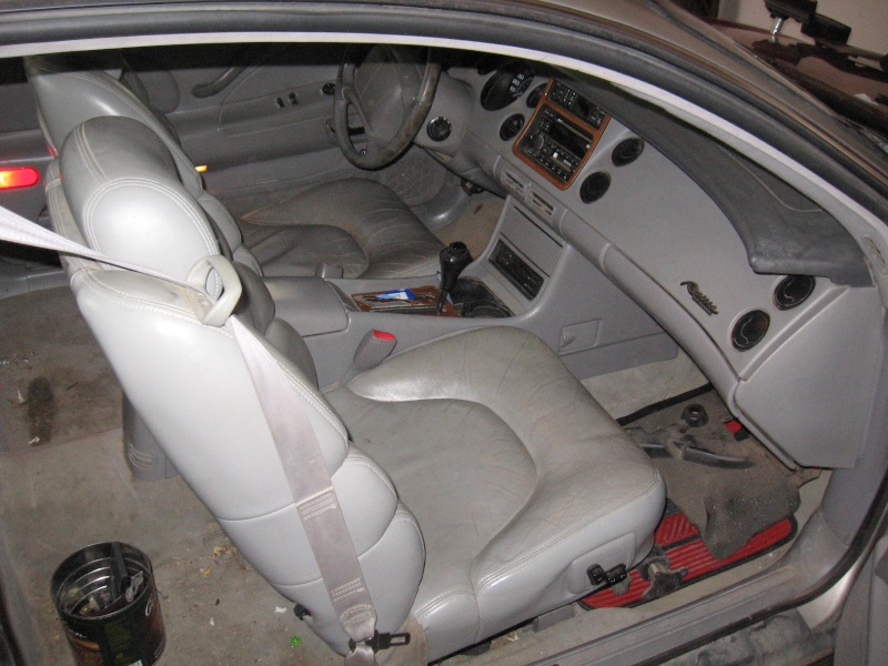

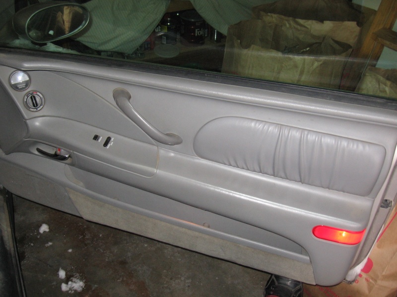

I have a 1997 beige n/a riviera with tan interior. I am changing to car to be maroon exterior on maroon interior. Here are some pictures before the interior is out. Some of the front of the car has already been changed to maroon.
Picture of interior:
Door:

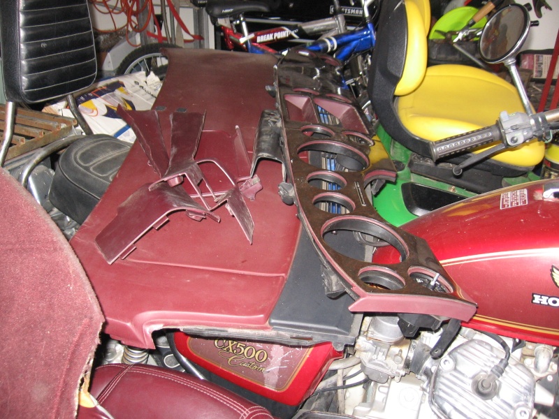

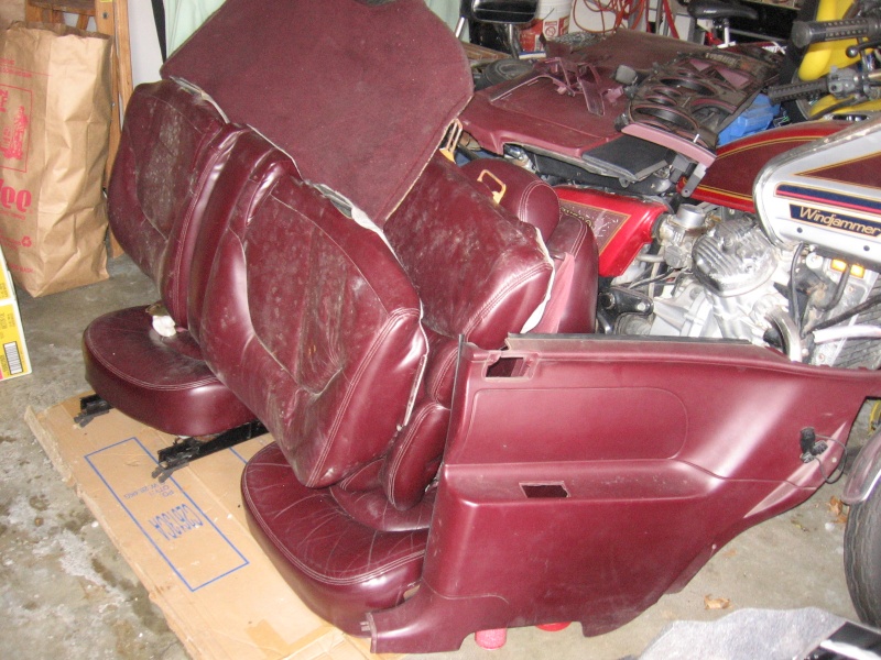

More pictures of the parts out of the maroon car:
Seats:
Dash Pieces:
Panel from backseat and center console:
Other misc parts:
I still have to take off doors with panels from maroon car and carpet and seat track of drivers side(having some problems see other post).

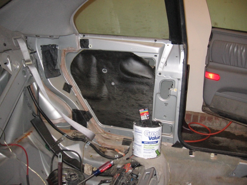

I will post some pics of the back of that panel.

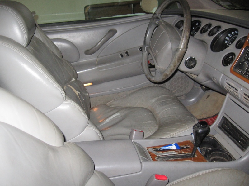

Here are some pics of what I have done:
Interior with seats taken out:
Rear Seat Area:
More interior where panel was:

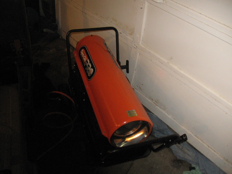

Heater Dad bought for garage since it was freezing lol:

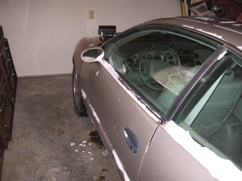

Rear Bumper Taken off to put maroon one one:
Front Seats:
Change that I found so far found $4.68, 3 beer bottle caps, a button and 2 duetschland coins:
Other side where panel is:
Shifter area:
Getting ready to pull out carpet will post more pictures.

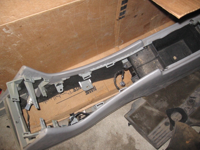

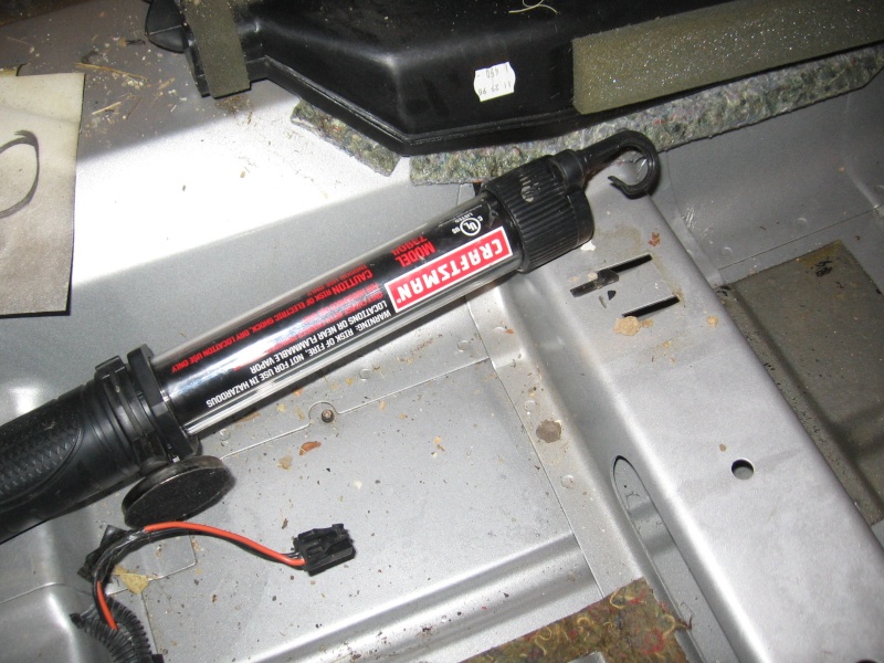

More pics without carpet:
Interior without anything:
I found this paper underneath the carpet it is printed 48 on one side on the other side it says 50 in pen anyone know what this is?
Found this under the carpet it is rubber no clue what it is maybe the factory left it in their on accident:
Shifter area:
Carpet:
Center Console:
If you look a litle above the light their is a white tag on the black shifter piece that says 450 it also says 11 25 96 I am guessing this is when the car or that black piece was assembled but no clue what the 450 means:
