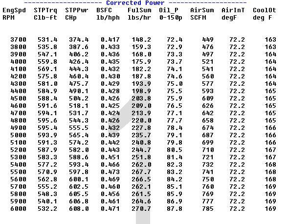

I haven't updated this thread in awhile because this motor never made it into my car. When the builder pulled it apart to check it out (he didn't like some of the subsequent dyno readings), he discovered some wear on the #4 main bearing. He eventually traced it to a weakness in this particular block. He had to source me another block, and build me a second complete engine. We dialed the cam down a bit to get more engine vacuum. This time, we used a 231*/238*, 112* LSA, with .550/.571 lift. The engine made 602.3 HP @ 5900 RPM, and 589.1 TQ @ 4900 RPM.
My new 470 BBB LHLevel2HRfinal
My shop finally took delivery of this engine at the end of August. I drove my car up to Chappaqua and swapped the engines over a 2 day period, then drove home and back to finish the fuel system.
Drove the car down to Cecil County Dragway (170 mile), and made 7 passes on Drag Radialos. I had a very difficult time hooking this car up. The calculated altitude was 1400', and that sucks for this track. When the air is good here, it can be below sea level. I still got the car solidly into the 11's. When I get everything sorted out, look for low elevens. Click on the pictures for the video.

PostSubject: Re: My new 470 BBB   My new 470 BBB EmptySat Sep 22, 2012 10:06 pm
Those dyno numbers are quite impressive. Super flat torque, +/- 10 lb/ft across most of the band, dropping off near the top, but I bet you're above 500 lb/ft all the way down to idle. Mix in RPM with the slight torque peak at 4900, and your HP curve is about the most linear I've seen. I'd think every big block owner would kill to have numbers like yours. Amazing. Nice job!

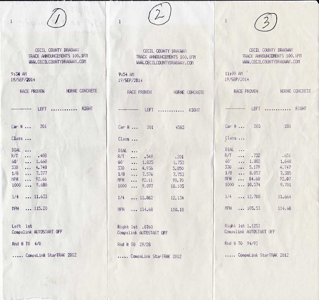

Just got back from Cecil County Dragway.  Another great Buick event.  Had a new personal best, 11.54 at 115.00 MPH.  Also ran an 11.58 @ 115.89.  Drove the car 175 miles down to Maryland , made 6 mid 11 second passes, and drove home, getting at one point, 18 MPG.  I love it!

Damn Larry, that's some consistent driving! What happened in run 2?

PostSubject: Re: My new 470 BBB   My new 470 BBB EmptyTue Sep 23, 2014 2:32 pm
I've got to get my LeSabre done!
I started off with 18 psi in the MT Drag Radials, and rolled up on the converter to 2000 RPM for run 1. On run 2, I dropped down to 16 psi, and launched at 2500. It didn't like it and spun the drag radials, not bad, but enough to lose 2 tenths off my 60'. I went back to 18 psi/2000 launch, and it hooked consistently after that. FWIW, I use a Switch Pitch Transmission, and a Gear Vendors Overdrive Unit.. The 12" torque converter is heavy because of the internals. I launch in high stall and switch to low stall about 3 seconds into the run. I could probably pick up quite a bit by going to a 9 or 10" fixed pitch converter that was built for my car, but that would probably impact my gas mileage. I may in fact go to a 4L80E which is a THM400 with a .70 Overdrive 4th gear. It also has a lock up converter. That would give me the best of both worlds if I had a high stall lock up converter.
