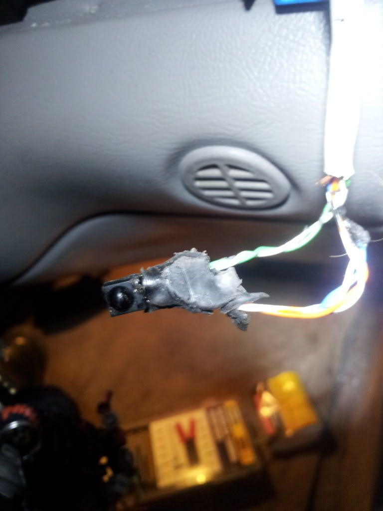

Chasing down a bad ground and I found this... what is it?

Looks like a bad splice, where do the wires go?

Way back into the dash this looks like phone wire with something on it. I found it stuck to the dash

That looks like cat-5 cable. Nothing to do with the OEM wiring.

Could it be something from a carphone? Im not sure if this car came with one originally.

Wow, that is wacky.

No idea what it is... snakes into my dash and vanishes..
