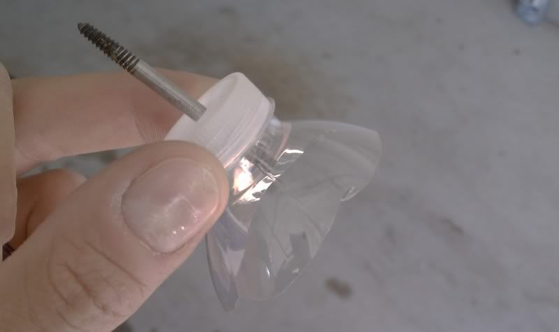

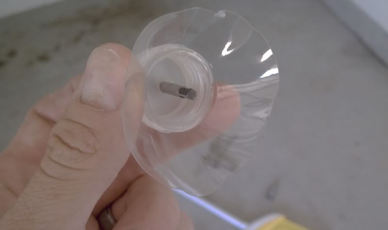

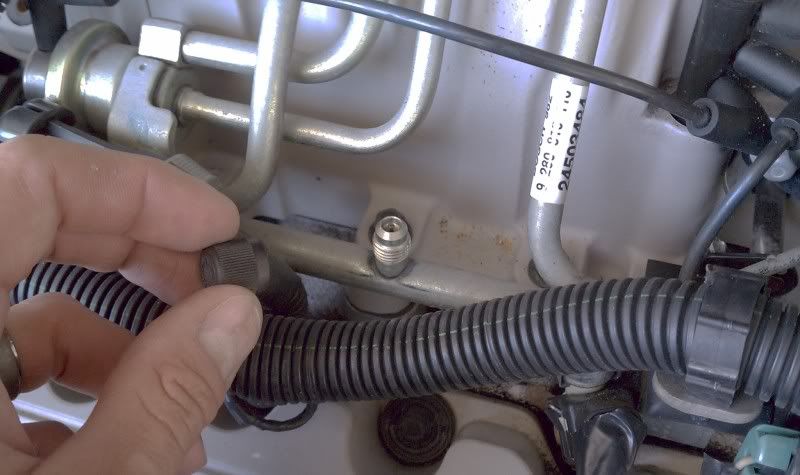

The next step is optional, but very easy so I recommend it to keep things clean. under the hood locate the bleed valve on the fuel rail and remove the cap, using something small ( like a small drill bit ) press down on the pin on the valve to relive the pressure. I cut the top of a small water bottle off and ran the drill bit through the center of the cap to prevent fuel from spraying up, I cut the base out of that same bottle and put it under the fuel rail to catch the fuel, this proved to be very successful as no fuel was spilled during this process.

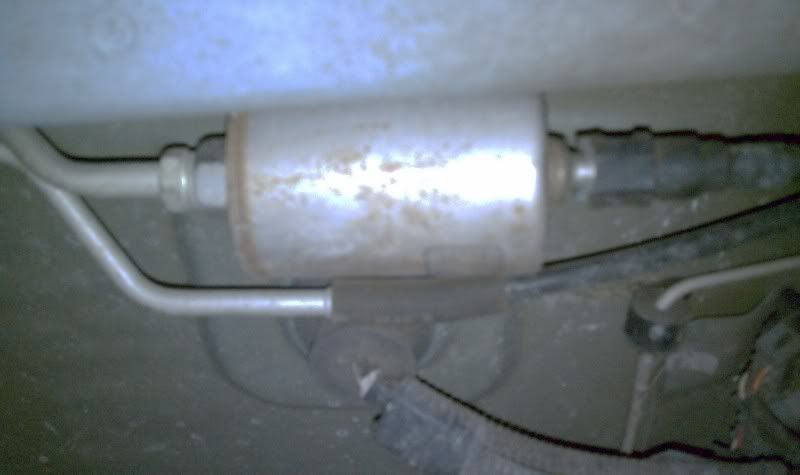

Next locate the location of your filter. At first glance I could not see it, mainly because the filter is actually tucked up under the car and not really visible unless you really get under there. you can always follow the fuel lines under the car to locate the filter. You should be looking under the driver side, just in front of the rear tire.
There she is! I was really lucky with the condition of my old filter, very little rust! this is the first time I have done it since owning the car so im not sure of the age.

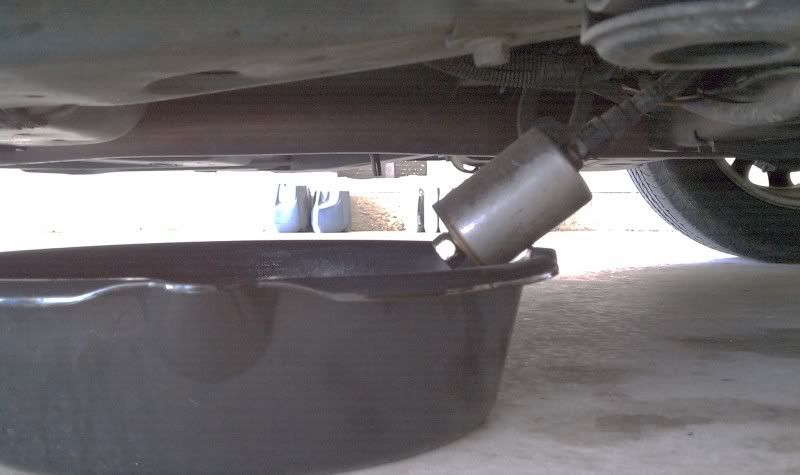

Assuming you have already let the compression fitting soak in PB blaster if needed, go ahead and place your fuel catch bin under the filter and break the fitting loose. I clamped the vise grip onto the filter and broke the compression fitting loose with the 5/8's, it was surprisingly easy despite punching myself in the face when it broke free. you should not get any fuel to pour out by simply breaking this fitting loose, however once you separate the filter from the fitting you will get a decent amount of fuel coming from the lines. the filter can now be moved into position for easy removal of the rear fitting.

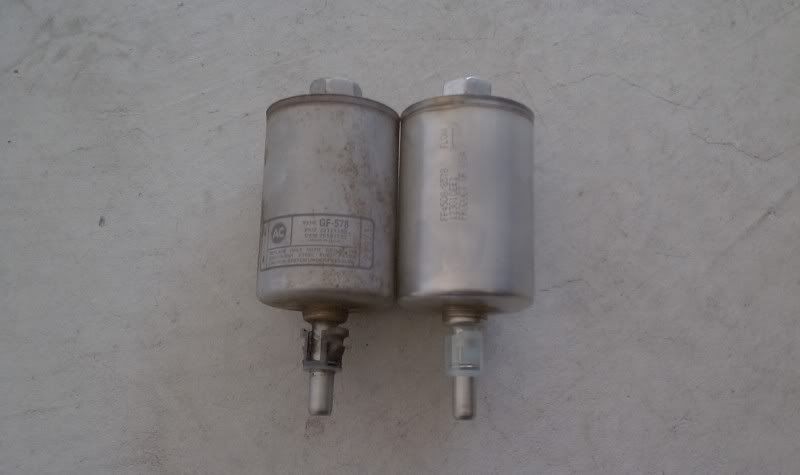

This should be the easy side, simply locate the two tabs on the clip and squeeze and separate the fuel line from the filter. be careful, more fuel will come from either the fuel line or the filter. now you can compare the new vs. the old.
