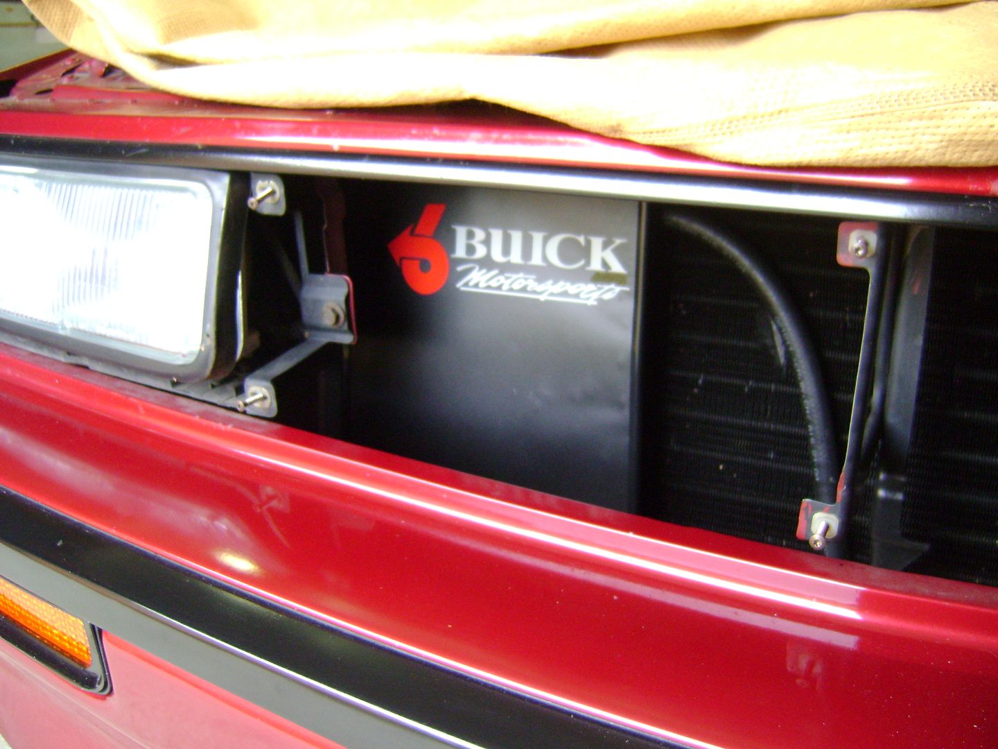

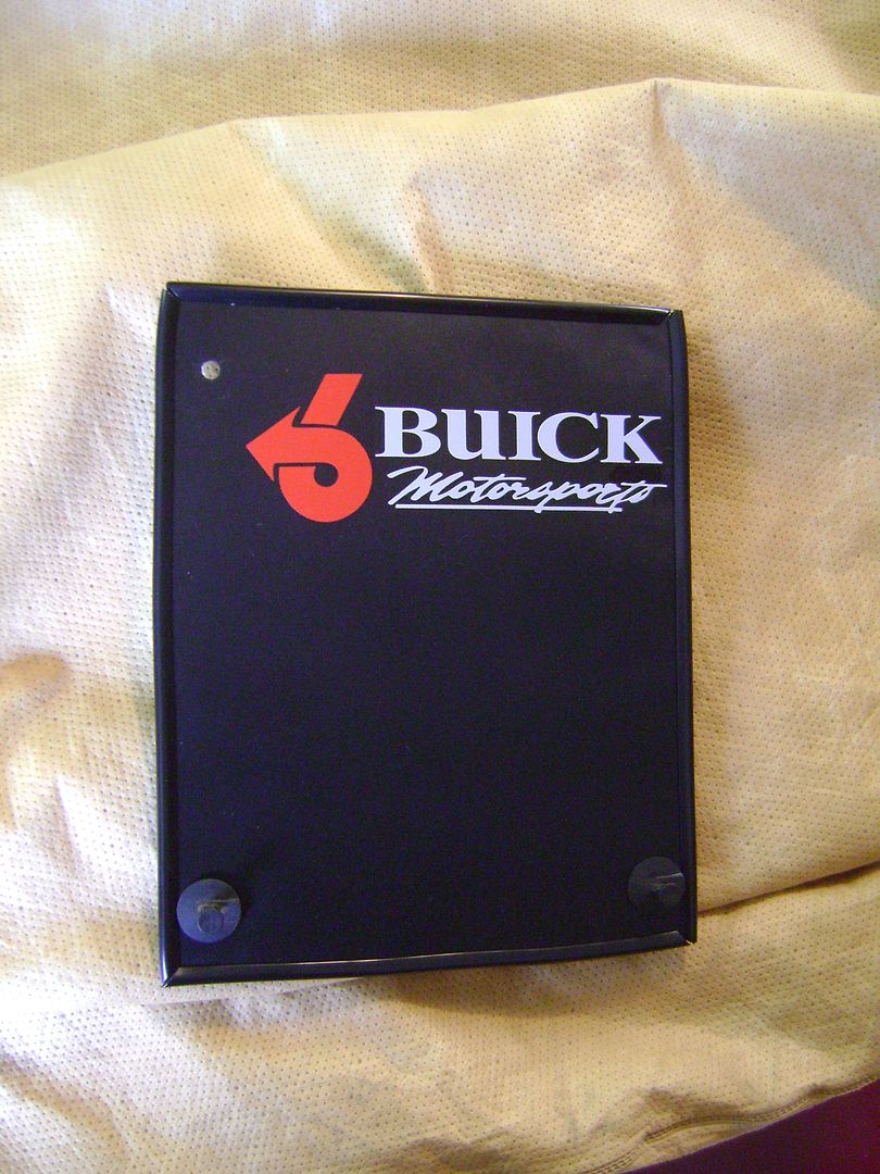

I did one small thing today though. I made this:

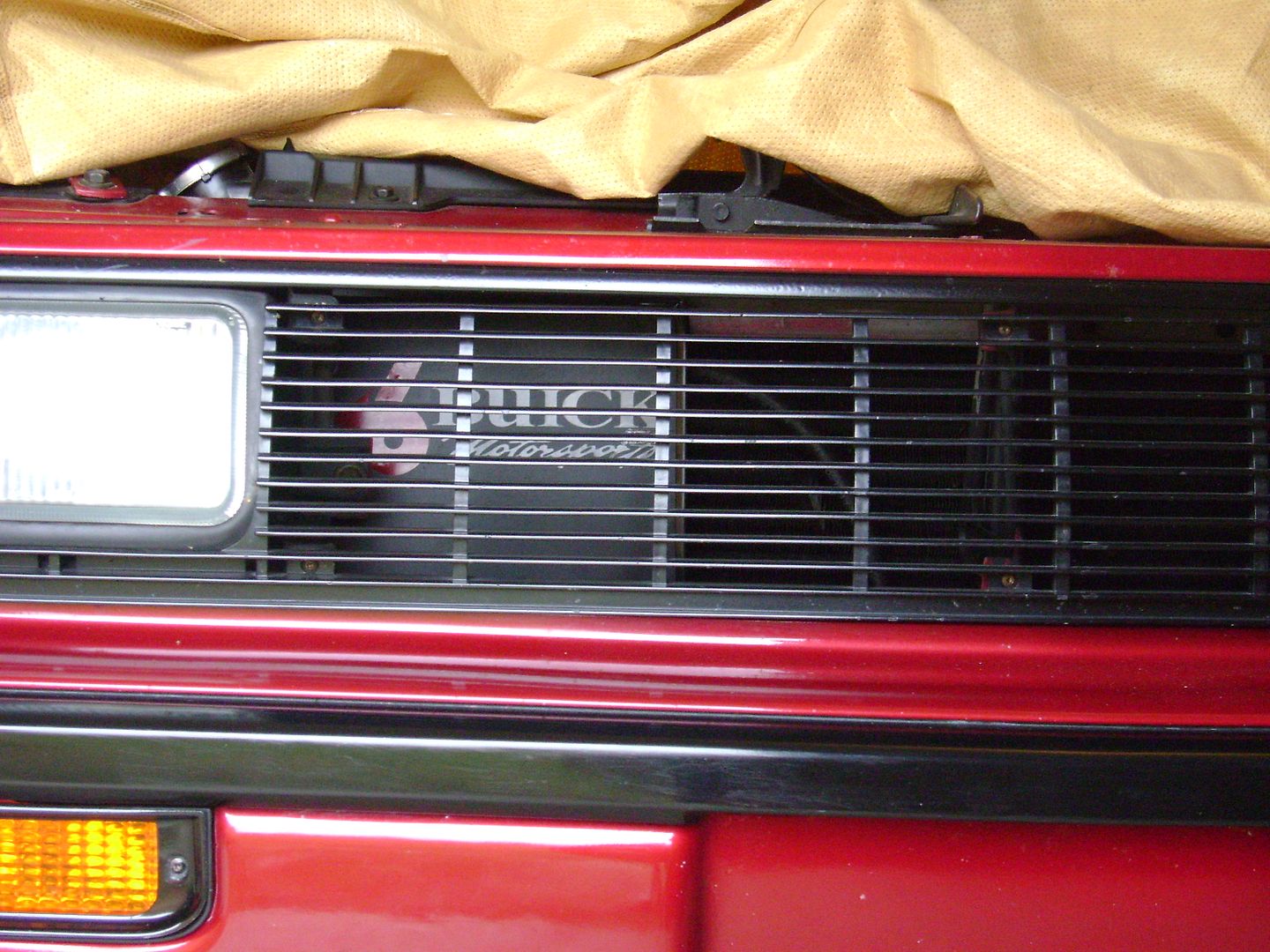

What is it, you ask? It's a block-off plate for my transmission cooler. Just for the cooler months when even my redirection valve can't keep up. I made it out of a sheet of aluminum, backed it with 1/2" foam, painted it black, and added door edge guard to it so it didn't look tacky. It actually fastens to the brackets that hold my trans cooler to the car with those push pins - very convenient.
You don't really notice it with the grille in, but then again, you're not supposed to.

Looks great Andrew!
69GSColorado Fanatic
Name : Jordon Joined : 2011-07-16Post Count : 406 Merit : 29
Subject: Re: My L67 swap from LesabreT.com Fri Apr 05, 2013 12:15 am
Very sinister!
Joined : 2007-07-01Post Count : 2556 Merit : 12
Subject: Re: My L67 swap from LesabreT.com Fri Apr 05, 2013 1:00 am
great idea

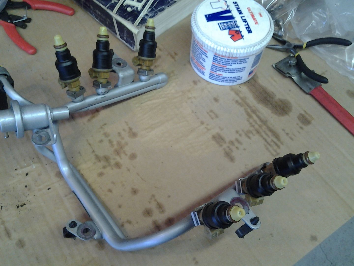

She lives! Actually, me and my fiance put the injectors back on yesterday, changed the oil, and put coolant back in. Few pics first.
In this picture I've already installed the injectors, but you can see they look BRAND NEW!
The guys at Mr. Injector really offer a fantastic service for an awesome price. They sent me a results chart of before and after statistics on each injector, and a bunch of Jolly Ranchers! I didn't scan the results sheet into the computer but it breaks down like this: #1 - before, flowed 75 #2 - before, flowed 77 #3 - before, flowed 73 #4 - before, flowed 73 #5 - before, flowed 72 #6 - before, flowed 75
Afterward, they all flowed at 100% at 77. Seeing the end results, I'm so glad I sent them out to get cleaned and rebuilt. A few of them there were getting ugly...
So anyway, Alyssa and I got everything going and turned the engine over for about 10 seconds at a time to try and get the lifters pumped a bit. I put the fuel pump relay back in and the car fired right up, but man was it noisy. I was a little scared and a little pissed because I figured everything was tight and right. But, after letting it run for a minute and just keeping calm the engine quieted right down and all was well.

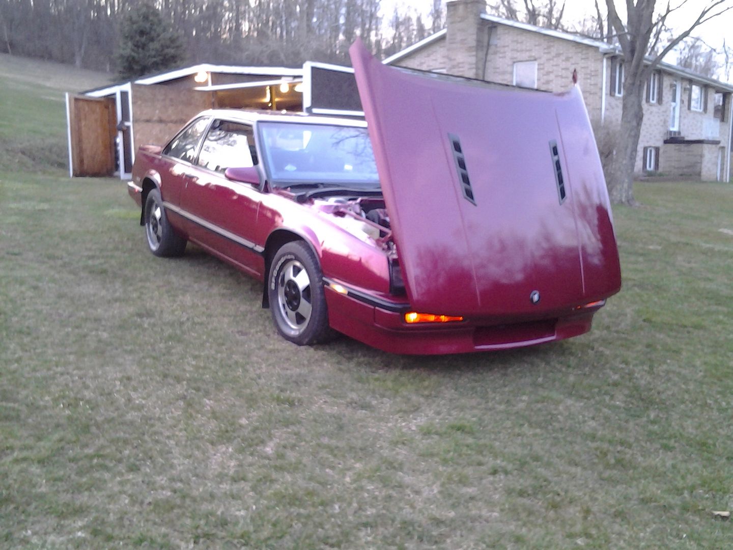

Today, when I got home from work dad and I put the hood back on and I took it for a ride. The engine definitely has a huge and noticeable increase in power. Without even getting into boost, the car just pulls and pulls. It's amazing the difference those rockers made. Honestly, this car is to the point now where I'm wondering if putting the rockers on was a good idea lol. I'm terrified of this thing. I took it on a 10 mile drive and I just couldn't get it to wide open throttle...it was too much!
Totally worth it .

Awesome! It is amazing how dirty the injectors get. I don't know of any tank cleaner that works as well as sending them out, although I do tend to dump a can of techron in all my cars at each oil change.
