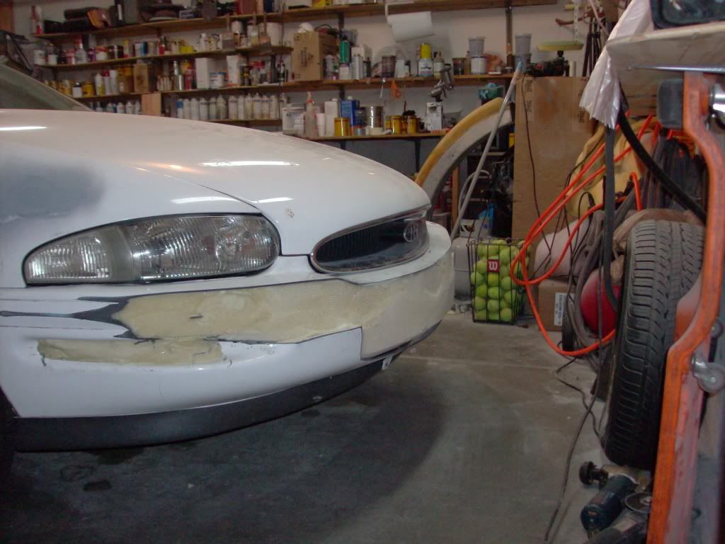

Yeah,the body is super straight.the left fender got pretzeled one night when my belly was full of rum and my eyeballs didnt see the parking post comin at me.I banged it out pretty good.just got to sharpen the lines a littleI
I removed the side moldings and hope to do a good job filling in the gap.I dont have the metal skills to weld in a steel panel,but I bonded a thick piece of aluminium into the cavity left by the molding.just a question of carefully filling the gaps.I'll do all the work myself.

Alu is very light VS steel or bondo.The reason I used alu channel was to fill the gap left by the moldings so as to not use a ton of bondo.hate that.
I wanted to weld formed steel sheet in place,but I dont have the metal working tools or a low enough heat setting on my wire feed welder or the skilz! Cant afford to hire someone to do it so..it's the next best thing.Time will tell if I made a good choice in terms of durability.

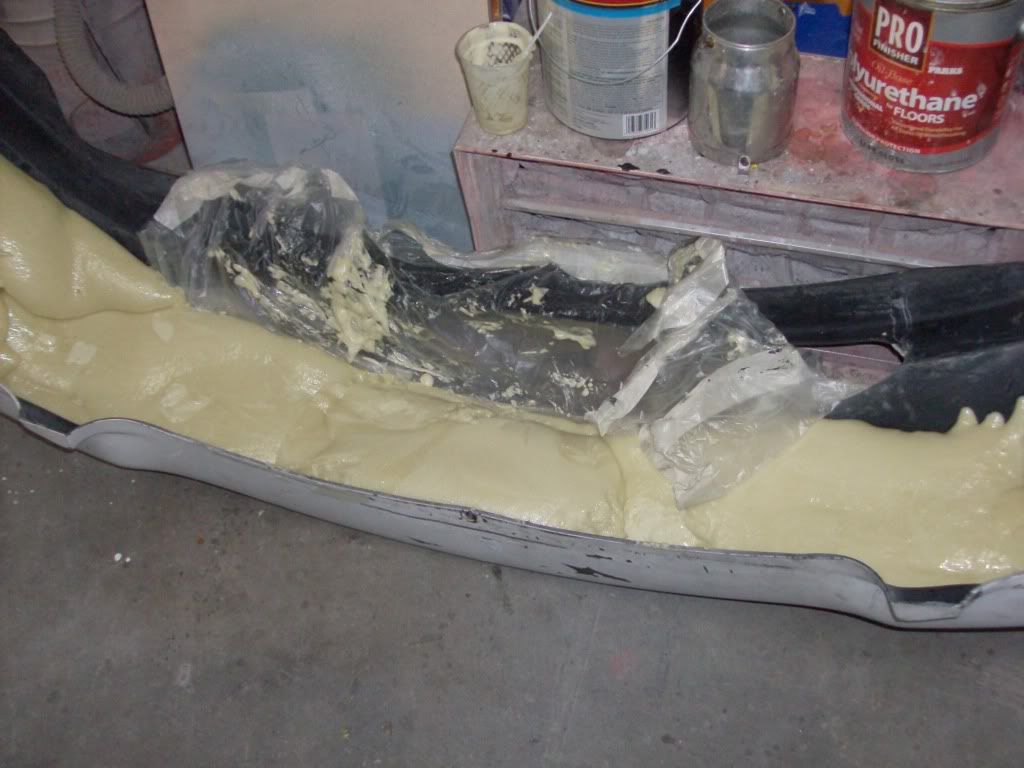

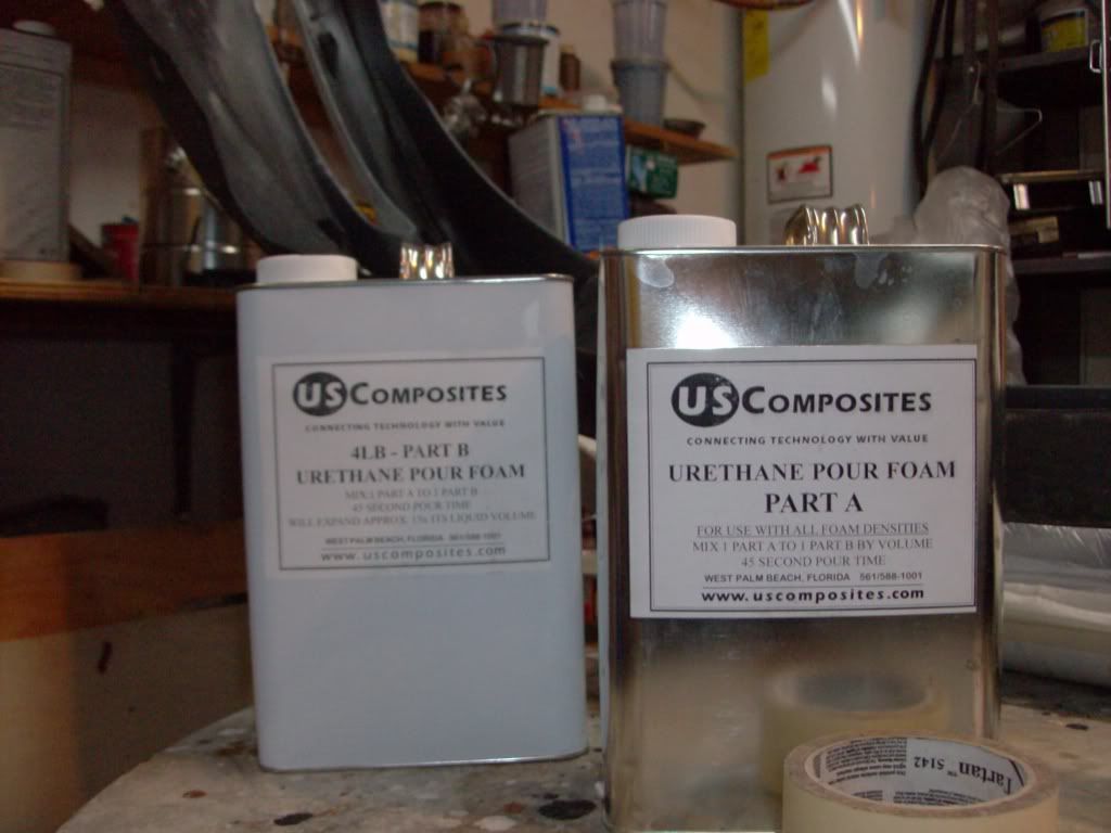

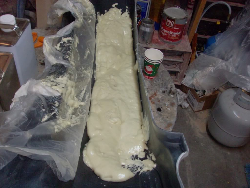

well I was really close at one point $ wise to buying a Sqrivi bumper set. But the $ alas had to go elsewhere. so Ive come up with an idea to make it happen for less.still love the Sqrivi set but out of my price range for now.
I dont know for sure if I can make this work,but im gonna try.
the plan is to fill the inside of the bumper with 2 part expanding foam, $30 for a 4 lb kit.
pour it into the upturned bumper.when cured I will then take a sander to it and sculpt the bumper to my taste.after I got it where I want it,ill glass it all in. lets see what happens.pass or fail,Ill learn a thing or 2 and wont be out much. heres a few pics to show
preppin for paint - Page 2 HPIM1366

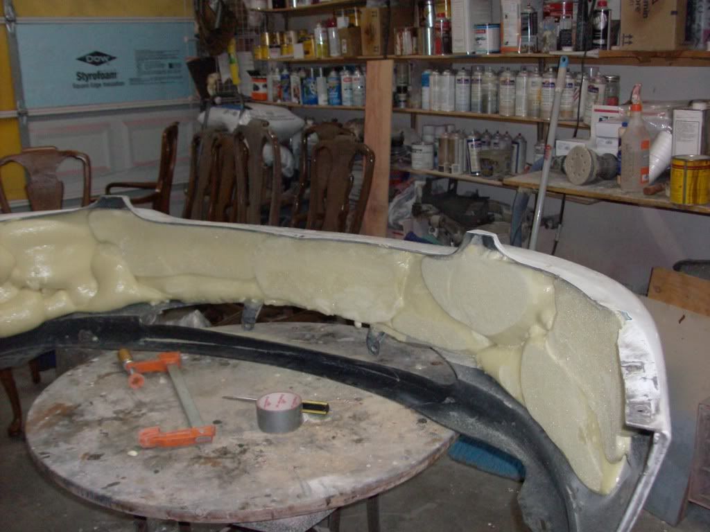

heres a pic of foam all cured and a little sanding done. sands real good.
preppin for paint - Page 2 HPIM1371

heres a few more after lopping off the front of the bumper.a whole lot more to cut off and shape though.gettin tired cant think...
preppin for paint - Page 2 HPIM1373
preppin for paint - Page 2 HPIM1372

a couple more pics of the bumper.a really rough profiling of the mod.dont know for sure the final shape the bumper will have but ill take it slow and see what happens.
the foam sand really easy.
preppin for paint - Page 2 HPIM1375
preppin for paint - Page 2 HPIM1374

A few more pics..It's coming along nicely.So far my plan is working with only a few hicups.I missed a key step.I failed to sand down the inside of the bumper,this is causing delamination issues between the poly foam and the urethane.no prob,The foam is just a guide for the Fglass.
the plan is to add a few inches to the bottom of the bumper.I think that would look sharper.also gonna increase the width near the wheels.this will cover more of the inside edge of the tire.
preppin for paint - Page 2 HPIM1377
preppin for paint - Page 2 HPIM1376
preppin for paint - Page 2 HPIM1378
preppin for paint - Page 2 HPIM1379
