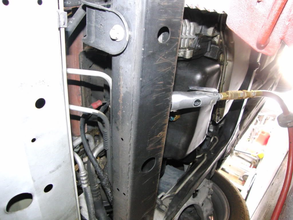

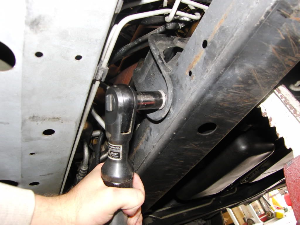

Okay, I just did my front and rear mounts this weekend with the help of a buddy on the rear mount.
The front trans mount is simple. It took me about 40 minutes, but the bulk of that time was cutting a piece of 2x4 by hand to use as a "mechanical persuasion tool." gavel I had every intention of doing a great photo write up on this repair, but I got into a time crunch with an evening out on the town with my wife to celebrate our 13th wedding anniversary. So, unfortunately, you'll see that I don't have squat for pictures for the rear repair. Once I got to the rear mount, I had to leave my garage twice... Once to Lowes to get a 24" half inch socket extension. (Of course, they didn't have it, so I had to "erector set" 3 10" extensions. Once I got the steering rack bolts out, I had to run to Autozone to get a 55 torx head socket for the lower mount bolts. All in all, it was pretty smooth, and I made the date with the wife. Which is probably the most important thing if I want to be able to "play" in the garage with the boys... rolleyes
I uploaded some pics to photobucket...
Rear Mount on the Left 3065. Front Mount on the Right 3127. (Both ordered from RockAuto, but shipped directly from Anchor)
FAQ: Engine/Transmission Motor Mounts - Page 6 CIMG0406
Shot of the forward mount
FAQ: Engine/Transmission Motor Mounts - Page 6 CIMG0408
Another shot of the forward mount
FAQ: Engine/Transmission Motor Mounts - Page 6 CIMG0411
Jack stand under the trans bracket supporting the engine and trans
FAQ: Engine/Transmission Motor Mounts - Page 6 CIMG0412
Using the floor jack, you can get the frame to the proper height of the trans bracket which will allow you to get the bolt holes to line up when you replace the mount with the new one.
FAQ: Engine/Transmission Motor Mounts - Page 6 CIMG0413
Took this shot without looking! shoved my hand under and shot! lol It's a great shot if I may say so myself! Here you can see the jack stand supporting the trans bracket.
FAQ: Engine/Transmission Motor Mounts - Page 6 CIMG0414
Here I'm removing the bolt that runs through the trans bracket and through the mount.
FAQ: Engine/Transmission Motor Mounts - Page 6 CIMG0416
Unbolt the mount from the frame.
FAQ: Engine/Transmission Motor Mounts - Page 6 CIMG0417
The old mount.
FAQ: Engine/Transmission Motor Mounts - Page 6 CIMG0419
The old mount versus the new mount.
FAQ: Engine/Transmission Motor Mounts - Page 6 CIMG0418
Another shot of the old mount. It seems there is less rubber cast into the original mounts versus the newer ones. Look at the side by side comparission picture above.
FAQ: Engine/Transmission Motor Mounts - Page 6 CIMG0420
My mount required a little "mechanical persuasion" so I used a 2x4 and tapped it into place for my frame bolt to pass through.
FAQ: Engine/Transmission Motor Mounts - Page 6 CIMG0421
This is the first shot of the job to replace the rear mount. You need a long extension and a universal to get the bolts off of the steering rack.
FAQ: Engine/Transmission Motor Mounts - Page 6 CIMG0422
Sorry again for the lack of photos on the rear mount. I was in a hurry... See my original comments above.
This is a comparrison of the old worn out rear mount and the new one.
FAQ: Engine/Transmission Motor Mounts - Page 6 CIMG0424
A couple of things for those of you that haven't done this yet... Make sure you have a long enough extension to reach those rack bolts, and make sure you have a 55 Torqx socket. I used some of the write up from here to help me out BECAUSE THE FACTORY SERVICE MANUAL IS USELESS. It's pretty straight forward for the rear, just take off the end links on the sway bar and you can rotate it out of the way to get the old mount out. The post I read talked about undoing subframe assembly bolts, and that is NOT needed. It will save you some time.
