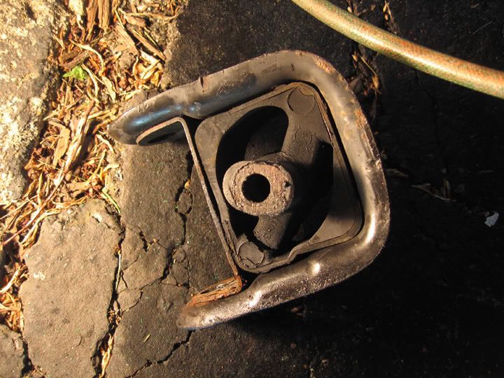

Old front mount:
FAQ: Engine/Transmission Motor Mounts - Page 7 IMG_0143
Noticed some more vibration in the steering wheel and the cabin at idle and thought I would check my front mount. It is broken in the same spot as above. I reved the engine in park while watching the mount and it moves pretty good when it is broken! I think I will try to use the window weld and fill the mount. This is the mount that I need correct?

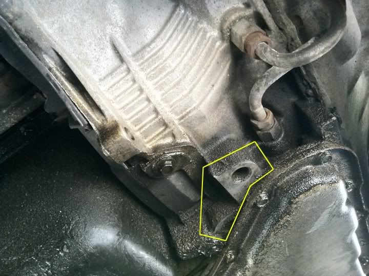

PostSubject: temp   FAQ: Engine/Transmission Motor Mounts - Page 7 EmptyMon Oct 31, 2011 4:23 pm
Yes that's it. If all you need to do is the front, it's an easy job to do yourself, using a jack to support the engine. With the car securely lifted on jack stands, here's a spot where you can raise/support the engine while swapping the mount. Can do this in 1/2 hour with practice!

I changed the front mount and ended up having to reuse the old bracket with the new bushing. The new bracket wouldn't bolt up to the subframe. The bolt holes wouldn't line up. A little more work, but not to bad. I filled up the mount with window weld and it held up pretty good being pressed into the new mount. A little bit came loose on one end, but I'm not concerned. I gave it a couple weeks to dry.

I haven't driven the car too much after I changed it, but it seems to be a less vibration now that I changed the mount. It seems to shift better and feel less clunky. The old mount had seen better days.

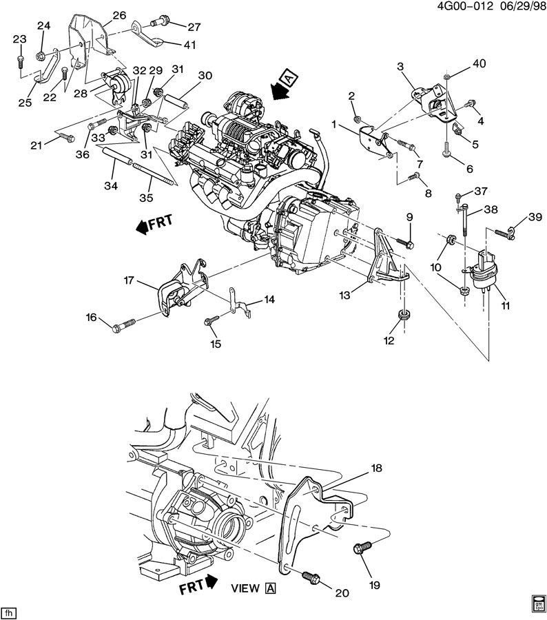

Our cars have 4 engine/transmission mounts. Here is a diagram showing their locations.
03 - rear
17 - front
11 - left
28 - right
FAQ: Engine/Transmission Motor Mounts - Page 7 1997-98_SC
