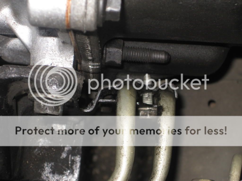

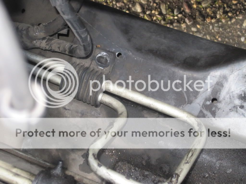

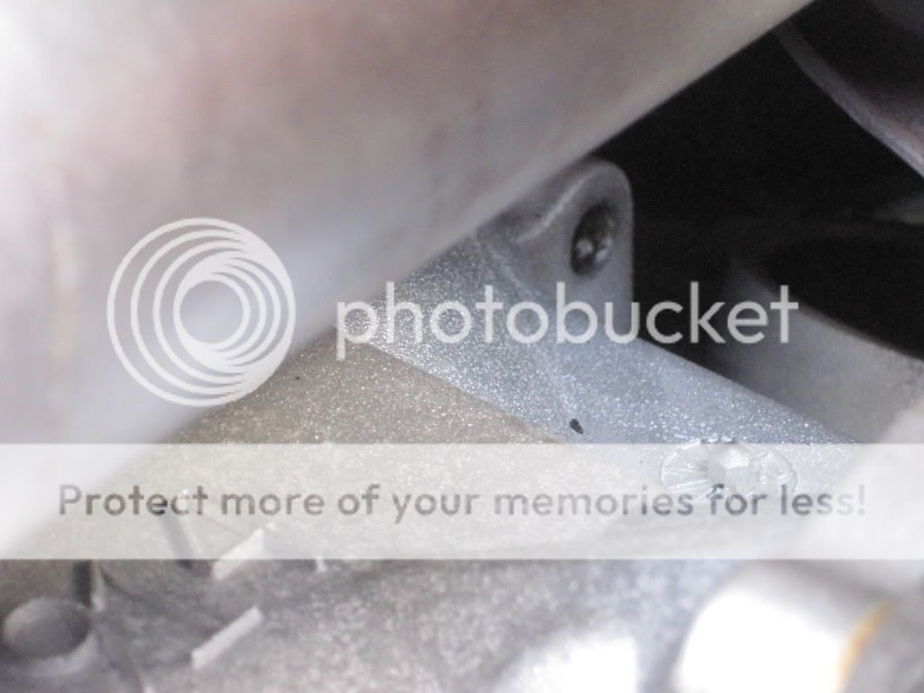

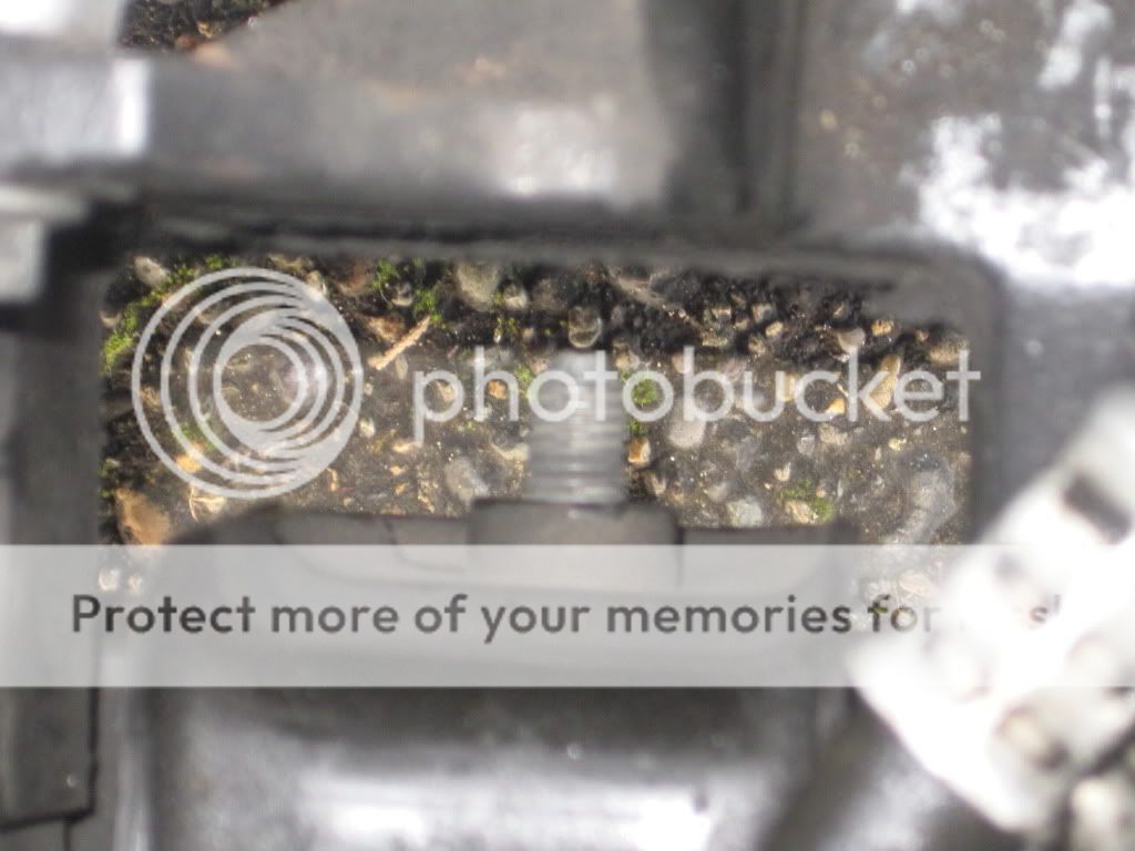

So I return to the shop tomorrow and I found a couple things that concern me. Some are worse than others but I need confirmation of what I'm seeing before I bring these up.
Tranny lines. Obviously they're supposed to be mounted somewhere.
This shows what I believe should be a bolt but alas, there is nothing. Located topside at about the 1 oclock position of the transmission case. Should there be a bolt there?
Again, tranny lines left unfastened
This has me a little concerned. Front Transmission mount, lower bolt. Should there be a nut there.

front mount looks OK
check rear mount and there are 2 more - a 'can' on the front of the engine and a transmission mount on the bell housing some wheres. I don't have pics.
I am thinking the mount on the bell housing usually does not get changed out and probably finally dies.
I am thinking the rest of that loose stuff needs bolted down.

Those look like power steering lines. The line running around the subframe is the PS "Cooler". The tab you showed on the transmission - not exactly sure which one you are showing, but there are two alignment holes that do not have bolts in them. There should be 5 visible bolts from the drivers side, the sixth bolt comes in from the passenger side behind the motor. If they were going to leave one out, it would have been that passenger side bolt commonly referred to as the "Bastard Bolt" because people don't know it's there, and can't pull the transmission after thinking they have removed all the bellhousing bolts.
The PS Cooler lines just thread into the subframe with those sheetmetal screws you see. Not a huge deal but you could even hold them up with a tie wrap just to ensure they don't drag on the ground. (not likely to happen)

Thanks for the correction - I was in a hurry while posting because I had to get an answer before I left the next morning. I don't know. Sometimes a person can convince themselves there's an issue even though it's exactly how it should be.
