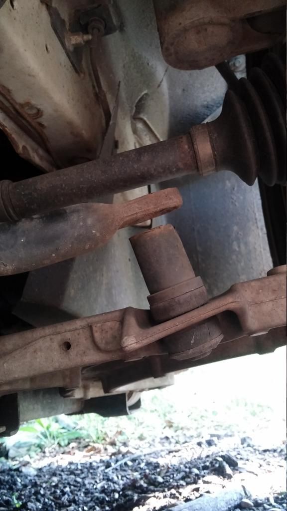

PostSubject: Re: Write-Up: Front/Rear (Addco) Stabilizer/Sway Bar Installation   Sun Sep 14, 2014 1:04 pm
I might need some end links...
Post Count : 7716
PostSubject: Re: Write-Up: Front/Rear (Addco) Stabilizer/Sway Bar Installation   Sun Sep 14, 2014 2:05 pm
Yeah, almost all our OEM end links look like that at some point or another!!!
KnottyEagle
Age : 20
Joined : 2014-08-29
Post Count : 284
PostSubject: Re: Write-Up: Front/Rear (Addco) Stabilizer/Sway Bar Installation   Sun Sep 14, 2014 2:29 pm
That's definitely the source of the clunking noise I've been hearing while turning.
Post Count : 18317
Merit : 239
PostSubject: Re: Write-Up: Front/Rear (Addco) Stabilizer/Sway Bar Installation   Sun Sep 14, 2014 3:35 pm
Search "links" and you may find some in our For Sale section - that will never need to replaced as long as you own the car.
