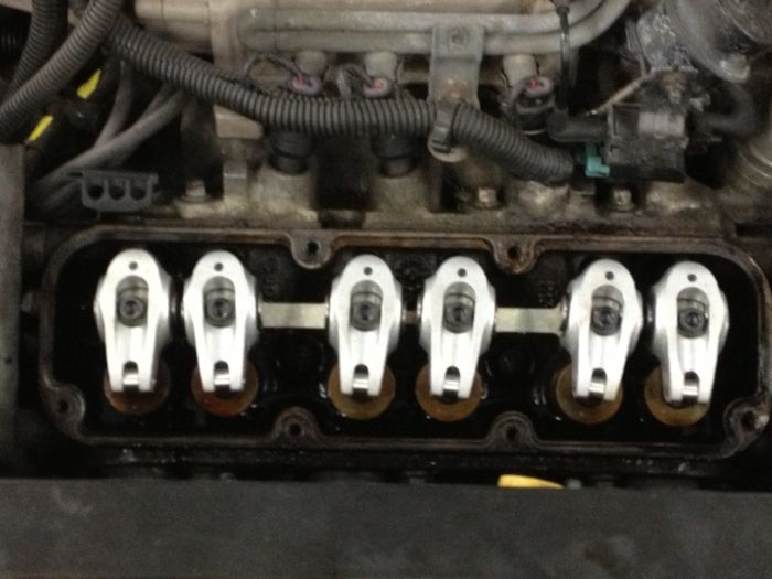

A pretty exciting start to my week as the last 2 days alot has happened with the Riv!
We started by temporarily setting up a boost gauge for now so we could see how the mods affected boost levels.
Riv finally back on the road - Page 2 9c6a082f-fce6-4cbc-a582-c946948ac802_zpsaffd6cdf
Sunday, when we put in the gauge, the car was reading between 6-7 psi on a couple of WOT runs. It was 60* outside at the time.
Last night and today, we put in the AL 104 plugs, swapped to the 2.5" S/C pulley and installed the Yella Terra 1.8:1 Roller Rockers and took in out for a ride this afternoon. I ran it light for a bit and everything was very smooth! Eventually took a few WOT runs and saw close to 11psi! Very noticeable increase in power and stong much higher into the RPM band. Temperature was down to 45 during the runs. Going to scan to make sure theres no KR tomorrow and get the car cleaned up as it definitely needs it after doing the RR's!
Riv finally back on the road - Page 2 2f5e45dd-e827-4b7a-9d2a-e0de464555ab_zps3748c6b0
Not sure whats next. Need to look into a tune in the near future and we would like to buy the software to tune the Series 1's and learn to tune ourselves eventually. For now, we're just going to look into having sinister tune the PCM for a bit until we're looking to do more with the car. Definitely a good feeling to hear the car turn over and run well after spending some time hunched over the motor! Certainly not the most comfortable position working in the back of this motor!

oh wow! did you use the stock springs and everything with the Yella Terras?
Yep! Reading around, the 1.8's dont usually cause issues on the stock valvetrain as long as everything is still in good working order! No problems on our setup. We'll see how everything holds up moving forward but the car revs strong at WOT and right into the next gear!

i know i have a computer in front of me but..wtf do Yella Terras do for the car? i mean,the oem rockers are roller bearing too!? right?

The OEM rockers are roller pivot but not roller tip. The YT's are designed to reduce the friction and keep the temps down. They're also claimed to be much stronger and quieter. They most definitely arent louder but the OEMs never made any sound so I dont think theres much difference there. Then the power comes from the increase in the higher lift duration. The installation was also a good chance to clean the pushrods which gather quite a bit of junk over time. Not sure if this affected performance at all but didnt want any unnecessary friction!
You can see the tips in the picture above. The OEMs were solid tips!

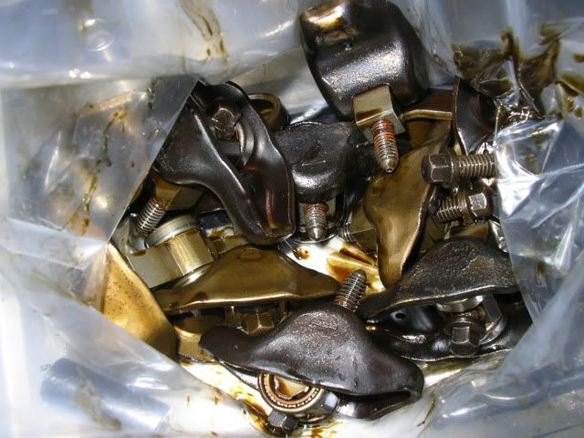

I think I explained it a little funny. The 95 OEM rockers do not have roller tips! Just the pivots so gm GM called them factory roller rockers but they are not true roller rockers because of the solid tip. Thats one of the upgrades with the Yella Terras. They provide the extra lift and are true roller rockers. Not sure how much friction the OEMs were creating but the tips do move across the top of the valvesprings so I do believe that the roller tips would have an advantage in addition to the higher lift.
I can take a picture of the stock rocker arms tomorrow and post it so you can see the differences!

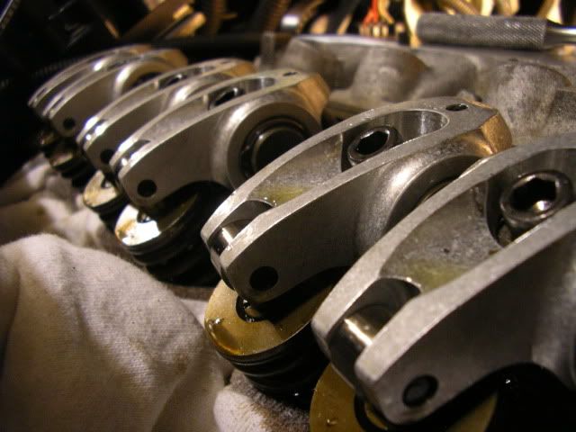

Stock 95 rockers:
Riv finally back on the road - Page 2 IMGP1412
The tip is rounded for a bit less friction when dragging across the valve stem. The 96+ are a more harsh edge. The advantage of moving to full bearing roller tips is a bit negligible on engines that only rev as high as ours, but the move to 1.8 ratio is noticeable.
Holy shit. you were running 11psi without scanning? WTF, man?! shocked
Haha, Charlie, I've been running 11-12 PSI for years!
th3fr4nchi5e:
Nice install, You will feel the 1.8s, and love the blower sound with the 2.5".
Riv finally back on the road - Page 2 IMGP1397
Welcome to the rocker club!
