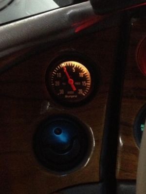

| Finished the boost gauge yesterday. We do eventually want to do something about the color to match the gauges but this will do for now! | |
