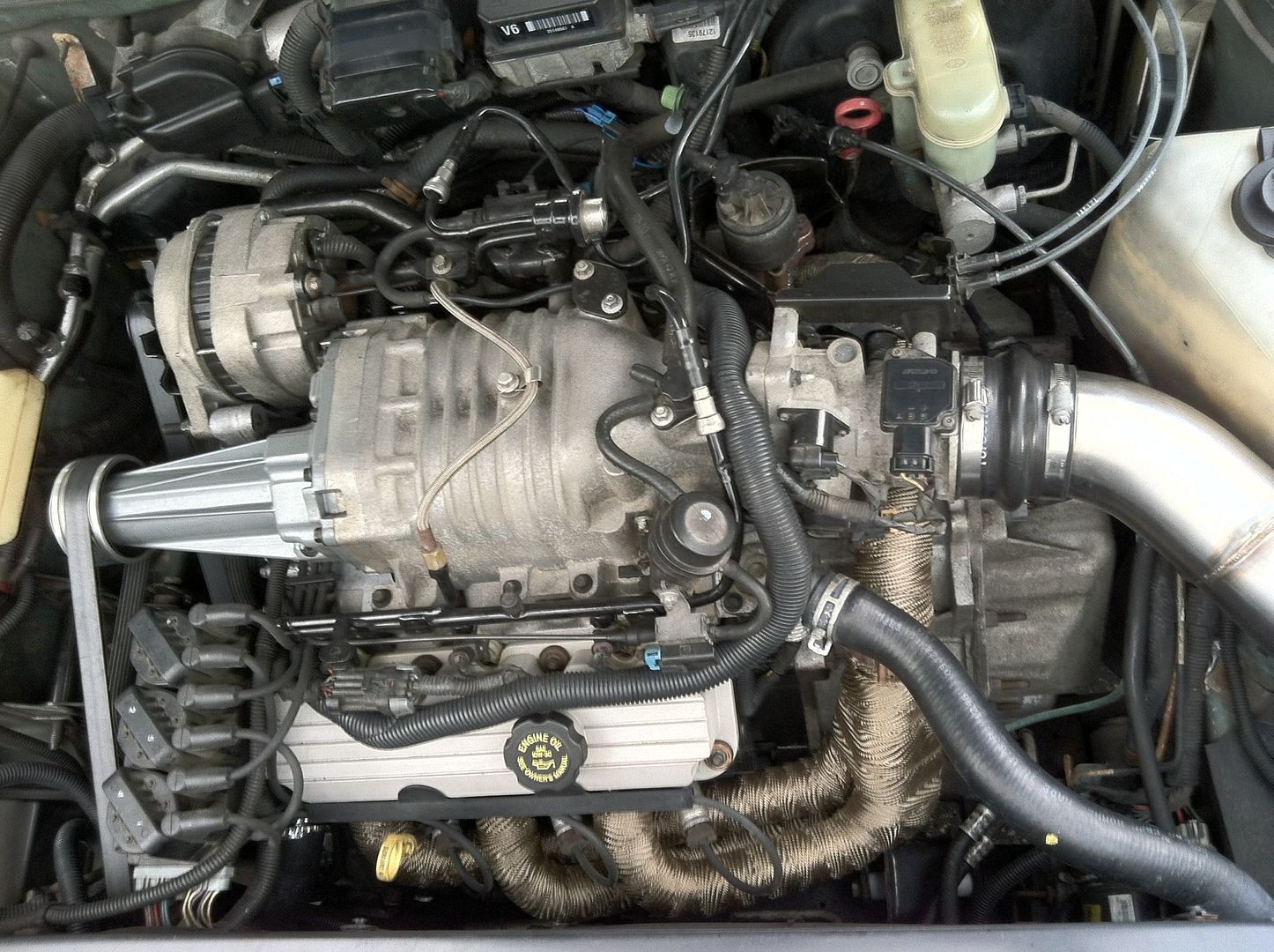

Post Count : 18336
PostSubject: Re: Write-Up: Wrapping Exhaust Headers   Tue Dec 18, 2012 8:03 pm
In addition to the comments posted above, I've put over 7000 miles on the engine. Amazingly, the wrap is still holding in place, and in like new condition. Winter will be the true test, but I've driven in plenty of rain with no issues. I think it helps that the engine isn't leaking any oil or coolant, and I'm careful not to spill fluids on the headers when under the hood.
A couple months after the install:
Post Count : 3912
PostSubject: Re: Write-Up: Wrapping Exhaust Headers   Tue Dec 18, 2012 8:10 pm
Beautiful. And it seems like you made it through the hottest part of summer without a hitch too. Very nice. I wouldn't wrap anything but the Ceramic SLPs. Just in case... ?
