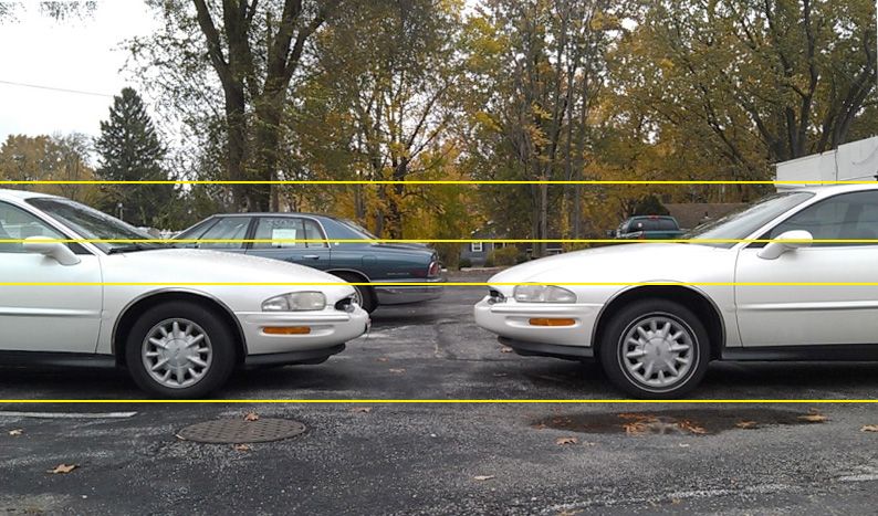

| Here's what a Riv looks like with Monroe quick struts after sitting on the springs for 3 weeks. (on the right) Normal Riv stance on OEMs on the left. | |

| With added clarity: _________________ '05 GTO 6.0L • 6-spd • 95k miles • 0-60: 4.8s • 16.9 avg MPG • Nelson Ledges Lap: 1:26'95 Celica GT 2.2L • 5-spd • 165k miles • 0-60: yes'98 SC Riviera • 281k miles • 298 HP/370 TQ • 0-60: 5.79s • ET: 13.97 @ 99.28 • 4087 lb • 20.1 avg MPG • Nelson Ledges Lap: 1:30 3.4" pulley • AL104 plugs • 180º t-stat • FWI w/K&N • 1.9:1 rockers • OR pushrods • LS6 valve springs • SLP headers • ZZP fuel rails KYB GR2 struts • MaxAir shocks • Addco sway bars • UMI bushings • GM STB • Enkei 18" EV5s w/ Dunlop DZ101s • F-body calipers EBC bluestuff/Hawk HP plus • SS lines • Brembo slotted discs • DHP tuned • Aeroforce • Hidden Hitch^^^ SOLD ^^^ '70 Ninety-Eight Holiday Coupe 455cid • 116k miles^^^ SOLD ^^^ | |

| Maybe mine is at OEM specs and the other car is what a sagging 13 year old OEM suspension looks like?

| The older Riv looks correct. You can tell the wheel arch is concentric with the outer edge of the tire. Compare the distance from tire tread to wheel well near the moulding and at the very top of tire. _________________ '05 GTO 6.0L • 6-spd • 95k miles • 0-60: 4.8s • 16.9 avg MPG • Nelson Ledges Lap: 1:26'95 Celica GT 2.2L • 5-spd • 165k miles • 0-60: yes'98 SC Riviera • 281k miles • 298 HP/370 TQ • 0-60: 5.79s • ET: 13.97 @ 99.28 • 4087 lb • 20.1 avg MPG • Nelson Ledges Lap: 1:30 3.4" pulley • AL104 plugs • 180º t-stat • FWI w/K&N • 1.9:1 rockers • OR pushrods • LS6 valve springs • SLP headers • ZZP fuel rails KYB GR2 struts • MaxAir shocks • Addco sway bars • UMI bushings • GM STB • Enkei 18" EV5s w/ Dunlop DZ101s • F-body calipers EBC bluestuff/Hawk HP plus • SS lines • Brembo slotted discs • DHP tuned • Aeroforce • Hidden Hitch^^^ SOLD ^^^ '70 Ninety-Eight Holiday Coupe 455cid • 116k miles^^^ SOLD ^^^ | |

| FWIW, a buddy of mine once put Monroe quick struts in his bonneville. He kept them in, but I always thought it looked comical how high the front sat. Like he was going to Dakar rally it or something. Perhaps the moogs, while handleing a bit better and not being quite as bad, are also just another "universal" part designed to sort of cover as many cars as possible. _________________ | |

| Wow, it really didn't look like much difference between your monroes and the moogs in the pictures. You were high in front, and still pretty high after the moogs. I could see how the monroes might hurt your mpg a tiny bit, but not 8 mpg worth - that's a big hit. Ecomodders have slammed cars to the ground and done extensive aero mods only to see less than a 5 mpg difference.
