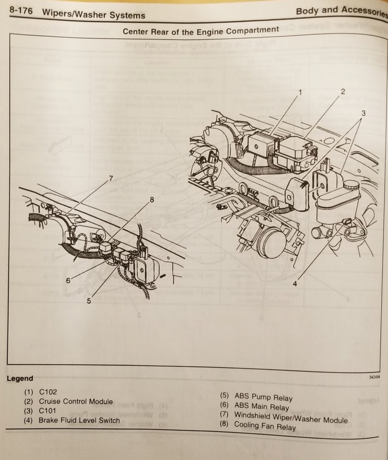

PostSubject: Re: Wipers won't turn off without shutting down the engine   Wipers won't turn off without shutting down the engine EmptyThu Dec 05, 2019 2:05 am
Heres the schematics and troubleshooting out of my manual.

Wipers won't turn off without shutting down the engine 3_wipe10
Wipers won't turn off without shutting down the engine 4_wipe10
Wipers won't turn off without shutting down the engine 2_wipe10

Wipers won't turn off without shutting down the engine 3_wipe11
Wipers won't turn off without shutting down the engine 1_wipe10

Wipers won't turn off without shutting down the engine 0_wipe11

Dmm is a digital multi meter. I gave you the connectors because the troubleshooting procedure leads you to check circuits ( wires ) or as it's called ckt as in ckt92 ...locate the connector with ckt92 and there you are. Also refers to connector numbers and specific socket location.hope this is all helpful

Relay is inside the wiper module as is the control board

That's the part that says replace the cover .its the brains of the operations

Looks easy to diagnose just follow steps . . May just turn out to be the switch

That's the motor not the board (cover)
