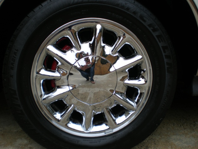

The next step is to clean the wheels and tires.
spray off the rim and tire making sure to jet stream the rotor above the caliper so as to rinse out as much brake dust as posible. then use the tire brush to sud up the wheel and rubber, and even the wheel wells if you can reach them.
Before:
Write-Up: How to Detail your Riviera Pb240016
During:
Write-Up: How to Detail your Riviera Pb240017
Rinsed & Dried:Write-Up: How to Detail your Riviera Pb240019
Ok now that you are sick of looking at my wheels, rinse over the entire car one last time making sure all the soap is gone.
Now dry the car off, top to bottom, and pull it into the garage to admire!

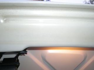

Your paint is covered in IFO's even after you just washed it!
what are IFO's?? IFO = Industrial Fall Out those are tiny minute particles that are stuck in the paint. They are things like brake dust, hard water minerals, and most commonly rust.
Even brand new cars from the factory have ifo's in the paint. these are more noticeable on white paint, and occur most heavily on the rear bumper.
it is hard to capture on camera but here is a micro shot of my bumper.
Write-Up: How to Detail your Riviera Pb240024
here is the same picture but i adjusted the contrast to highlight the IFO in the paint. Each of those spots is embeded rust in my pearly paint frown
Write-Up: How to Detail your Riviera Pb240025
keep in mind my paint was just washed minutes before this was taken! sponges cant get it out.
so what does? CLAY BARS! like the kind you played with in art class, only these are refined and made specifically for automotive use.
I prefer Clay Magic brand b/c it includes a large 100gram bar and lube for under $15 at Autozone.
What i usually do is split the bar in half, putting one in a separate plastic bag to save for later. you can do 1 fairly clean riv with ~50grams of clay.
you can use the clay on any non porous surface.
all you do is spray the provided lube (it's just spray detailer, but you can use water too) and then rub the clay back and fourth in linear movements to pull up the IFO's. reshape the bar frequently b/c you dont want to pick up anything large and drag it across the paint. you will notice the paint feels tons smoother and the bar is now full of dirt! throw it away when it is too dirty, or use it to clean up other things like rims, glass, tiles, or anything else to remove dirt or overspray.
