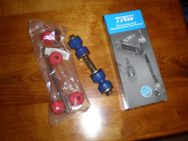

these are the sway bar links i used for the front: (advance auto has them in normal stock for $9 ea)
rear shocks, bar and bushings P1190013
i dont really notice any difference w/new links. it seems to change direction quicker and with more precision/response, but the body lean in corners hasnt changed.

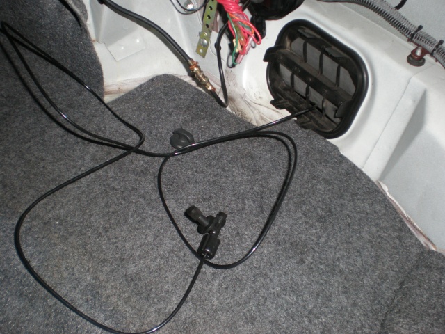

does anyone know where this line goes??? it runs from/to the air pump and i trace it back up over the gas tank, but i cant find where to unplug it from.

PostSubject: Re: rear shocks, bar and bushings   rear shocks, bar and bushings EmptyMon Jan 21, 2008 10:56 pm
Maybe that last one is the pump's "intake"? Just a guess.

PostSubject: Re: rear shocks, bar and bushings   rear shocks, bar and bushings EmptyMon Jan 21, 2008 10:59 pm
could be the intake for the pump! i didnt think of that lol
i know this sounds funny, but if i blow into the tube i hear air escaping from either the trunk or under the rear seat.
also, the shocks havent settled much, it sits at almost the same height with 0psi as it does with 90psi. maybe 1.5" difference either way. but it holds air and rides nice so i cant complain happy
