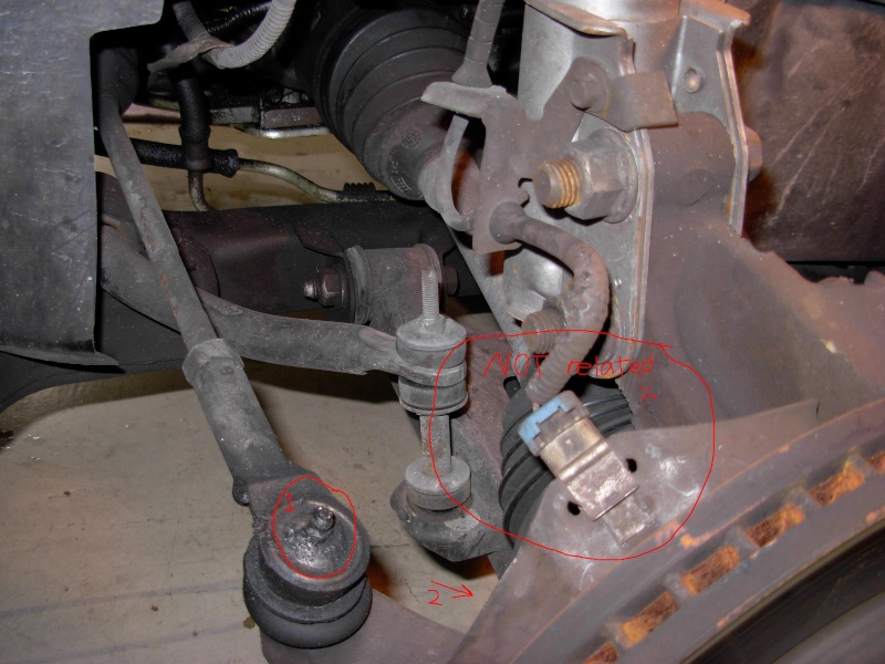

there are 2 zerk fittings for each of the front wheels, and 1 for each of the rear if i remember correctly.

Anyone got pics of these zerk fittings? What kind of grease should they be lubed with?

this is the only pic i have right now that shows any. this is of the front passenger wheel btw.

Like Matthew says, there are two on each front wheel, the outer tie-rods and the lower ball joints, mine came from the factory that way?

On the '98 there are also a couple on the rear links. Easy to see if a wheel is off.
