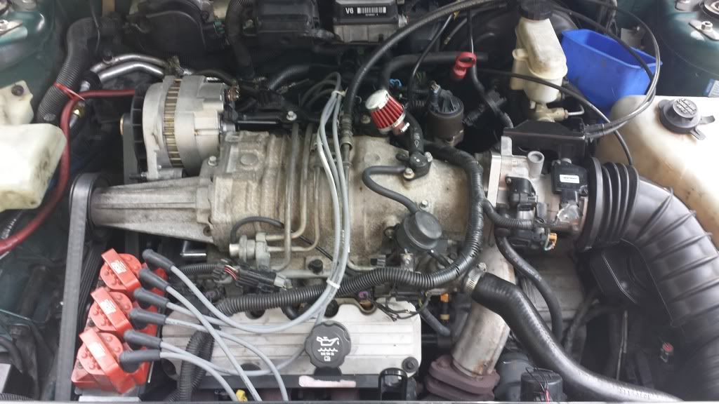

| I been had the series 3 the whole engine every part nothing was taken off of it besides the throttle body. I just need to see wa vacuum diagram to figure out my motor | |
| Subject: Re: series 3 Sun Nov 03, 2013 8:33 am | |
| The throttle body won't bolt on to the GenV supercharger (S3) without an adapter plate - it's unlikely you got a GenV supercharger swap in the process. It's most likely the old supercharger as well. Some pics of the supercharger would answer that, but most likely it's the stock Gen3 supercharger. | |

| Is that duct tape holding your MAF harness on? | |
Johnny5 Fanatic
Name : Going Nowhere Fast Age : 37 Location : Louisiana Joined : 2013-09-11 Post Count : 459 Merit : 1
| Subject: Re: series 3 Mon Nov 04, 2013 5:05 pm | |
| Lol man thats electrical tape falling off from the harness | |

| Johnny, not trying to pick your car apart so don't take this wrong. I just hope that maybe we can sort out some of your cars issues.
Your #3 and #5 cylinder injector wires look like they have been spliced. What is the condition of the splices on those and the other four that we can't see? Also, what is the purpose of the little air filter? | |

No no my friend what you are viewing was alot of son that day them are brand new bwd wires and the funnel has been there thru hard times I had forgot to change the lil rubber gasket on my drain plug and I used to leak oil | |
