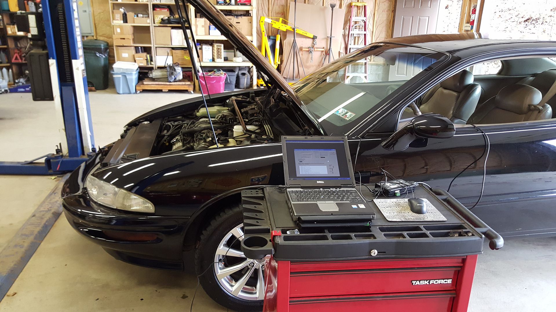

| - matt270avian wrote:
- charlieRobinson wrote:
- if you are + or - 5. that is amazing. i think + or - 10 is acceptable. anything outside of the range should be tightened up. better to be in the negatives tho
What do I get for being -3 to 0 all the time...? A pat on the back. | |
| | | turtleman Expert
| Subject: Re: Z-type's Tune Thread Sat Aug 29, 2015 3:24 pm | |
| On a car that's not cammed or such that fuel trims at idle are invariably sketchy, i'd be tryin' to get within 5%. I don't think within 3% is overkill at all but most importantly is to eliminate skew trends like when it's staying within reason at lower maf ranges and then adding or taking away more as you go up the table. That's what ruins your WOT afr and you don't even really get to see how badly unless you have a wideband or run full blast without PE and that's risky | |
| | | Z-type Aficionado
Name : Andrew Zamiska Age : 37 Location : Cecil, PA - 25 miles south of Pittsburgh Joined : 2009-06-29 Post Count : 1429 Merit : 63
| Subject: Re: Z-type's Tune Thread Mon Aug 31, 2015 9:15 pm | |
| Ok so within 5%...that should only take a few tunes for me. At heavy throttle, or really anything over 50%, I'm pretty much at 0.0. Just need to work on cruise and idle, which on my car, seems to be right around 5,000htz and lower where it's richer. | |
| | | Z-type Aficionado
| Subject: Re: Z-type's Tune Thread Wed Oct 28, 2015 6:18 pm | |
| I did an adjustment today with the MAF table. It seems the car was just a little lean at higher RPM/throttle, and the only thing I can really attribute that to was the new fuel pump. Maybe it's just a touch different than the stock one? Pressure is good. Anyway, I also toned down the shift pressures at 25% throttle and lower. Seemed a little harsh to me. All seems well now! I love tuning. I know I'm not doing and have never done anything hardcore as far as tuning, but I still love it. | |
| | | deekster_caddy Master
| Subject: Re: Z-type's Tune Thread Sun Nov 01, 2015 7:30 am | |
| - Z-type wrote:
- ... It seems the car was just a little lean at higher RPM/throttle, and the only thing I can really attribute that to was the new fuel pump. Maybe it's just a touch different than the stock one? Pressure is good.
... Absolutely. It's at high RPM/full throttle where you use the most fuel, so this makes complete sense. | |
