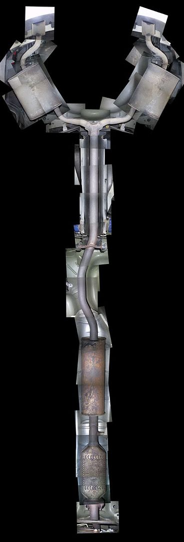

Here's a shot of the Riviera from below:
FAQ: The Exhaust Thread Rivbelow

ok in this above pic can u see the U bend???
Back to top Go down

Rivs don't have a U-bend.

HUH r u serious !!!!!!!!!!!!!!!! wow is that only GTP then?????? well then for me would i be able to install a 3 inch down pipe would that help me since i dont have headers??

W-bodies have them (GTP/GS). A 3" downpipe would certainly be an improvement!
