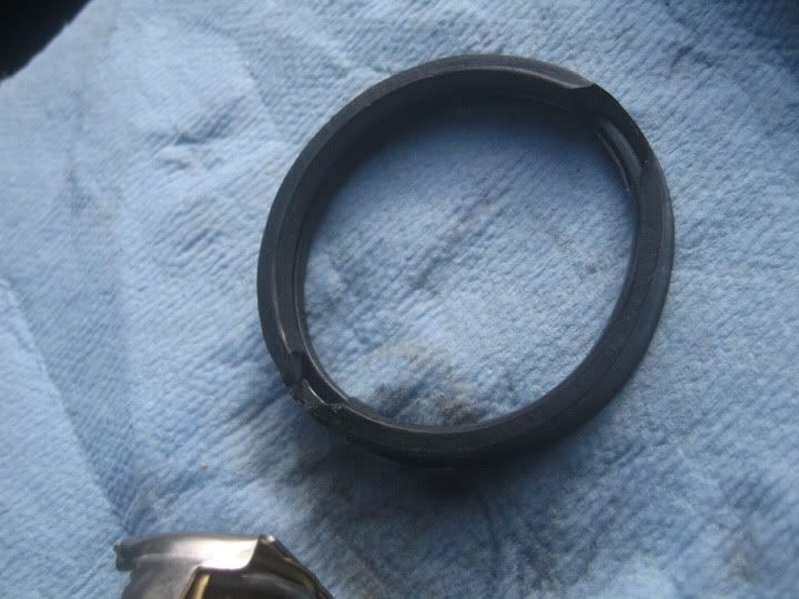

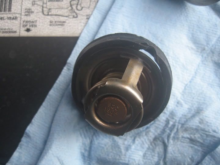

| Subject: Re: Should I replace my OEM thermostat? Sun Jan 08, 2012 1:29 am | |
| Turns out the older t-stat unit was a Motorad, but not the Fail-Safe type. Surprisingly, the unit had not failed. Instead I found the rubber o-ring seal had broken away in two spots, allowing coolant to flow around the t-stat. The points of failure correspond to locations of assembly/weld points, where the valve support attaches to the flat disc: Technically, the price of the repair was only $2.99 for the failed seal - I installed the new Fail-Safe t-stat since already I bought it. Will keep the other as back-up. _________________ '05 GTO 6.0L • 6-spd • 95k miles • 0-60: 4.8s • 16.9 avg MPG • Nelson Ledges Lap: 1:26'95 Celica GT 2.2L • 5-spd • 165k miles • 0-60: yes'98 SC Riviera • 281k miles • 298 HP/370 TQ • 0-60: 5.79s • ET: 13.97 @ 99.28 • 4087 lb • 20.1 avg MPG • Nelson Ledges Lap: 1:30 3.4" pulley • AL104 plugs • 180º t-stat • FWI w/K&N • 1.9:1 rockers • OR pushrods • LS6 valve springs • SLP headers • ZZP fuel rails KYB GR2 struts • MaxAir shocks • Addco sway bars • UMI bushings • GM STB • Enkei 18" EV5s w/ Dunlop DZ101s • F-body calipers EBC bluestuff/Hawk HP plus • SS lines • Brembo slotted discs • DHP tuned • Aeroforce • Hidden Hitch^^^ SOLD ^^^ '70 Ninety-Eight Holiday Coupe 455cid • 116k miles^^^ SOLD ^^^ | |

| Subject: Re: Should I replace my OEM thermostat? Wed Jan 11, 2012 12:56 am | |
| Aaron, where did you get the new stat-seal? I bought a couple from NAPA, and they were total garbage... They weighed about half as much as the old GM seal, and the edges looked like they had kids trying to cut circles out of rubber with scissors! So I just picked up a new stat from the dealer for $8 or $10, and the seal comes with it. | |
| Subject: Re: Should I replace my OEM thermostat? Wed Jan 11, 2012 10:07 am | |
| I'm not 100% sure, but I believe this is the OEM seal from GM. In my past t-stat swaps, I've never seen the need to change the seal until now. The new one is a Fel-Pro, sold through AutoZone as Duralast. Seems to fit just right. _________________ '05 GTO 6.0L • 6-spd • 95k miles • 0-60: 4.8s • 16.9 avg MPG • Nelson Ledges Lap: 1:26'95 Celica GT 2.2L • 5-spd • 165k miles • 0-60: yes'98 SC Riviera • 281k miles • 298 HP/370 TQ • 0-60: 5.79s • ET: 13.97 @ 99.28 • 4087 lb • 20.1 avg MPG • Nelson Ledges Lap: 1:30 3.4" pulley • AL104 plugs • 180º t-stat • FWI w/K&N • 1.9:1 rockers • OR pushrods • LS6 valve springs • SLP headers • ZZP fuel rails KYB GR2 struts • MaxAir shocks • Addco sway bars • UMI bushings • GM STB • Enkei 18" EV5s w/ Dunlop DZ101s • F-body calipers EBC bluestuff/Hawk HP plus • SS lines • Brembo slotted discs • DHP tuned • Aeroforce • Hidden Hitch^^^ SOLD ^^^ '70 Ninety-Eight Holiday Coupe 455cid • 116k miles^^^ SOLD ^^^ | |

| Subject: Re: Should I replace my OEM thermostat? Thu Jan 12, 2012 1:23 am | |
| That may well be - I don't have AutoZone out here... and this IS the first time I've been disappointed by Napa. I was surprised that I needed a new seal! In search of my 2MPG loss I decided (especially for winter) to put a new 195 stat in place of my drilled 180. (Turns out that neither injector-cleaner nor a hotter, undrilled stat made a difference on my round-trip to Clear Lake at Christmas.) However, when I was swapping out the 180 stat, I found that the rubber seal had 'dimples' in it from, of all things, aluminum corrosion - corrosion that was only where the seal was pressed between the manifold and and outlet... In the last year, between stat, and hose, and radiator replacements, I've surely replaced all the coolant, but I guess I need to give it some of that extra Prestone additive mixture... | |
