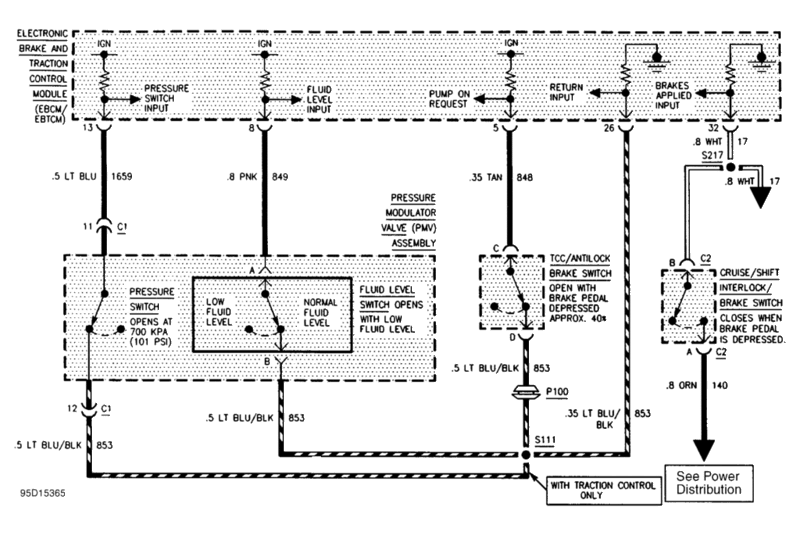

| Eldo is half right, so he gets a + Code 74 will set when the EBTCM detects an open in ckt #853 or ckt #1659, a short to ground in ckt #1659 with the brakes applied, or a failed PMV pressure switch. The flow chart is 3 pages long. I'll post if you'd like. By the schematic, it appears that the TCC/Antilock Brake Switch could set this code also (ckt 853). Also, check the HZRD/STOP fuse in the block under the back seat..... | |
