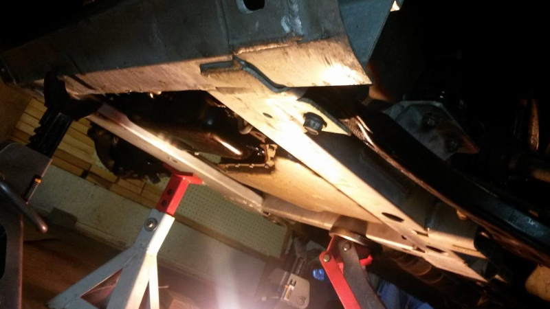

Rack took a dump on the Regal.  So I replaced that.. along with aluminum subframe install.  Still buttoning it all up but about 80% there now.
2001 Regal turbo and 2002 Sierra Denali Al_sub10
2001 Regal turbo and 2002 Sierra Denali Al_sub11

Woah, Aluminum subframe! Did you fab that up yourself?

Some 04+ w-bodies got aluminum subframes.  About 20 lbs lighter.  Looks nicer.  It was free.  Figured why not.
2001 Regal turbo and 2002 Sierra Denali Alumin10
Got the rack connected to the steering shaft and pump installed yesterday.  Just need to connect the lines to the pump and button everything up around that.  Then alignment, of course.
Whole thing was a good learning experience.  If anyone ends up needing to do a rack on their car, it's not horribly difficult.  It just looks a little overwhelming at first.
