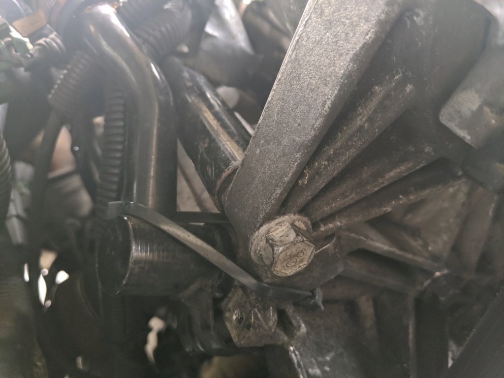

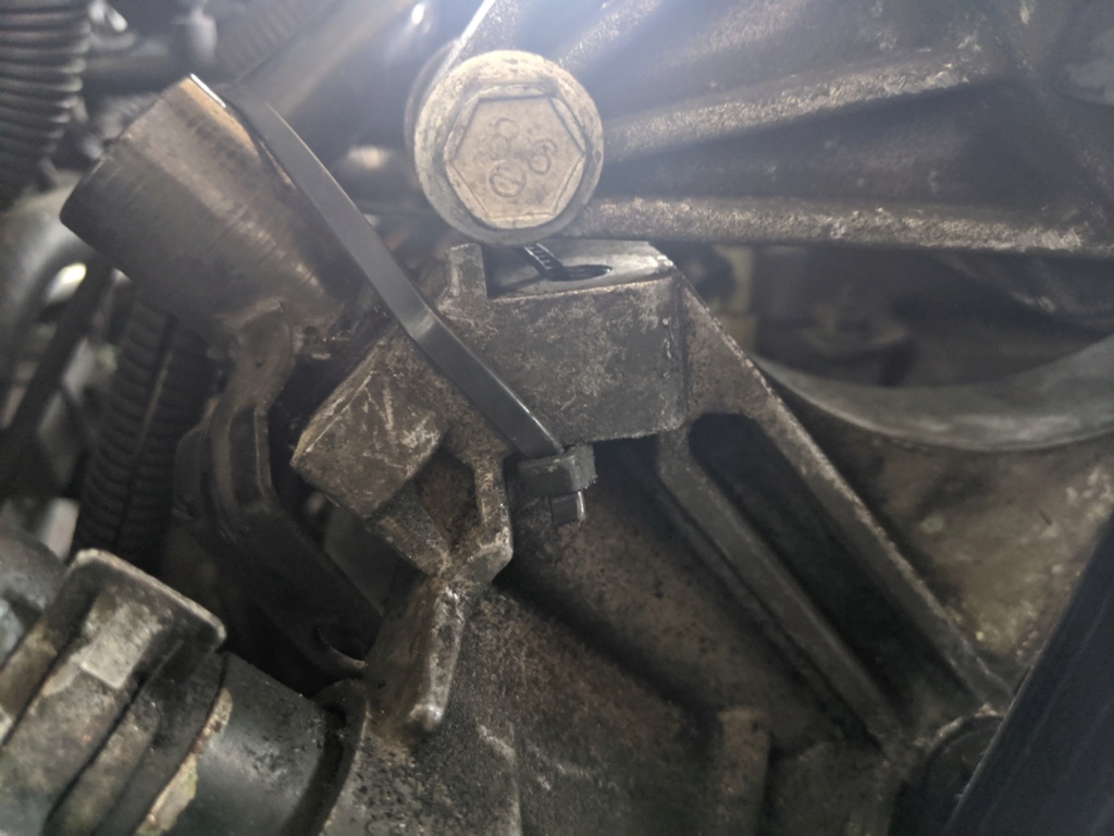

Hey all whats up? Tyler here. Just picked up a 97 Riviera with 168k miles. Supercharged. Got a few problems to sort out. The previous peopel wasn't too smart lol.
Picked it up since my other vehicle quit due to a electronic problem so just needing a way back and forth to work.
Also no clue why they have the supercharger not hooked up. It spins free no noise. The tensioner setup for it is missing. When i ask why it wasn't hooked up she said she didn't even need it or no what a Supercharger was for. Hahaha. So going to get the stuff to test it. Also had the temp sensor unplugged. Power steering fluid was low.
First is the common steering bracket being broke problem. Which is a easy fix just aquiring the parts.
The gas gauge doesn't work.
Next is when you crank it and it's idling there is some vibration from the pass side back of the engine. Rev pass 1.5-2k rpm it's completely gone.
When going about 50 it vibrates bad. Gently tap the brake it's gone.
They have a wire ran by the pass fender to touch to turn the starter over.

I do not understand the top bracket on your engine. I wonder if your engine was swapped and I wonder if you have issues with the motor and transmission mounts. Does your VIN begin with 1?
Oh nice didn't know that about the pullies. Not sure about the top mount. What's the l67 supposed to look like?
Honestly i think it's been swapped and the only thing i think if is the gtp. If you notice the mount by the throttle body there eis a broken upper motor mount bracket there. The rivs don't use upper motor mounts
Honestly i think it's been swapped and the only thing i think if is the gtp. If you notice the mount by the throttle body there is a broken upper motor mount bracket there. The rivs don't use upper motor mounts
Makes sense. I *think* if you find a donor car you could get the proper mounts. For instance GM still sells the proper lower (drivers side) transmission mounts. I think they are 22201114, 22178776, 22174975. Look them up on line just to see the pictures. Then make sure you have them and if not get the cores from a junkyard (you might have to call an LKQ or Row52.com and have them picked for you) and then you can get new anchor cores for short money. This page has a diagram:
https://www.davisgmcanadaparts.ca/auto-parts/1997/buick/riviera/base-trim/3-8l-v6-gas-engine/engine-cat/engine-mounting-scat/?part_number=22201114
you might also need to get 22174975 and associated pieces.
Why the engine installer did not move the SC tensioner and belt with the SC I have no clue.
The big hint for me, looking at the pic you posted, is the fuel injection tubing did not look right (wrong color), there was a funny black steel tube bolted to top of the engine, and the spark plug and various other engine wiring is not attached to the motor with standoff clips as they should be. You *can* obviously run without them attached but after a while stuff will fray and loosen causing various gremlins. Those clips and such would be pick and pull items, if you found a Riv or say a early to mid 2000s Park Avenue you'd be able to scavenge the needed parts for those attachments.
The reason I asked if your car's VIN started with 1 - I don't care what the VIN is -- but *IF* I remember right, the cars that started VIN with 1 are supercharged, L67 engine, and have the right PCM computer programmed for the job. The others were K (letter #11 - get it?) standing for the normally-aspirated L36 engine. You need to know which, because this info will help you for troubleshooting. The SC motor with blower disconnected is kind of a dog, it is lower compression on purpose than the NA motor, and might run funny at the limits because it's expecting forced air for combustion, not getting any, and there is only so far the PCM can adjust for that given the mass air flow sensor and MAP data. Unless the PCM was swapped too. You'd need a factory scan tool to find out, or you'd need to go behind the glove compartment and pull the PCM and read the factory or rebuilder's tag.
It will be interesting to see how you get all this sorted.
My guess is whoever did the engine swap possibly didn't, or was told not to, care, but most likely could not obtain the parts needed to fit the time or schedule or budget available. The needed parts and cores can be obtained from junkyards and should bolt onto pretty much whatever L engine and 4T transmission. I say "should" because on the one hand GM doesn't put a lot of variation into hard parts, but in some cases you'd find an unused hole that's already threaded but it might be that you'd find a boss that needed to be drilled and tapped to accept a bolt. Depending on where that is, might be impractical. You'll have to look and use your judgement to decide what to so. You'll also need to buy a (genuine) factory service manual.

Meh. The whole time i was looking over the car and test driving it she kept saying if i had any problems to get her mechanic to work on it. He is good.
So think i figured out what the funky brace is for. Also the silver under the air box was unplugged as was the 2 plugs on the transmission where the linkage is.
Plugged all them up and it crank right up. No sure what in the hell is going on.
I'm getting this is what's causing my vibrating idle.

I don't know how good a mechanic is if he's got a brace bolted to the supercharger where the plastic cover attaches to. I'll go get a pic of mine and show you what shoulld be going on there, although you may already know. I'm sure that spot on the SC isn't supposed to have any mechanical force going into it.
That zip tie deal - looks like it is holding on one of the heater core hose quick connects? I can see the quick connect isn't bolted into place, but I don't see where the bolt hole is. Could be a GTP difference, different style belt tensioner I mean. I'll go get a pic of that too.

Yea idk. I'm just wondering why they used that brace for the alternator mount. That's alot of force. And why these is no alternator bracket.
