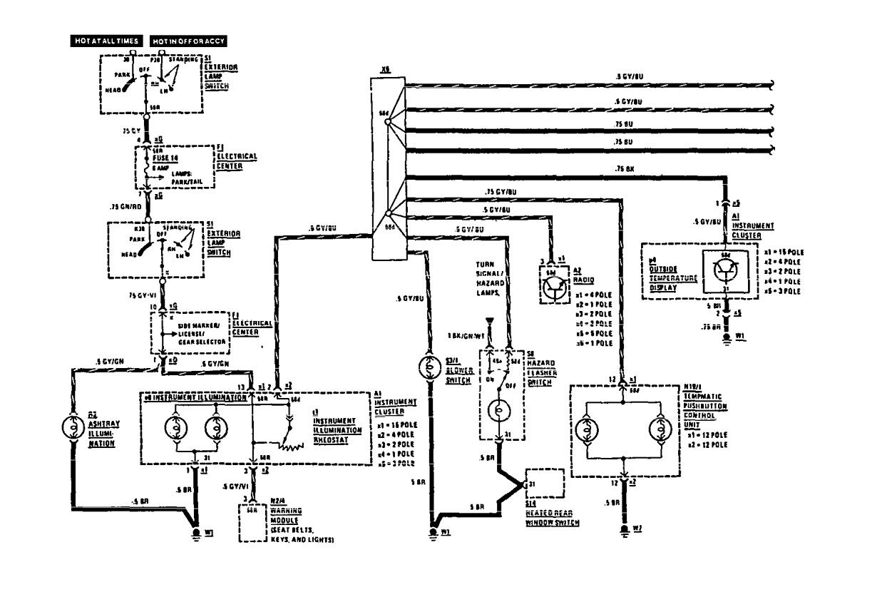

AFAIK the LEDs can be installed to illuminate the climate control - they are already used in the control's indicators. To do that requires some disassembly and some soldering. However, the incandescent lights hit the "eye ease green" color of the other dash lights better. There is a write up on this on this site.
https://www.carknowledge.info/wp-content/uploads/2018/02/mercedes-benz-190e-wiring-diagram-instrument-panel-lamps-1-1991.jpg
I looked at a '91 Merc 190E diagram for the instrument lights. On your Mercedes did you use LEDs in the instrument panel as well as the interior cabin, and how did the dimming functions work once the LEDs were installed?
