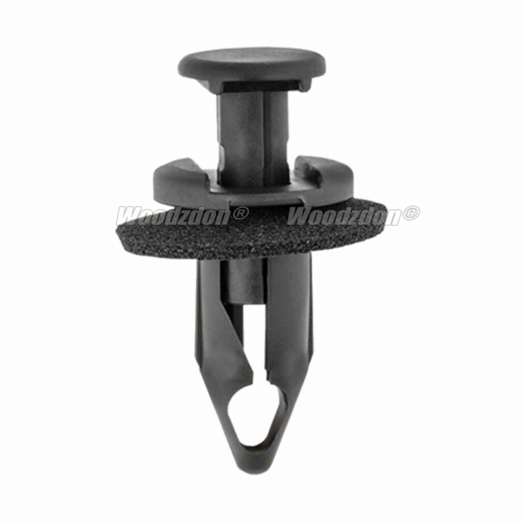

97 Riviera wheel opening moulding  S-l16010
these clips hold wheel open clips in pop the round head up and remove then the metal clip will release
