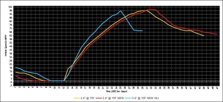

I have 135k on my old ones and they obviously needed cleaning because my idle is now perfectly smooth and my Kr is completely gone.
I had nearly the same results. Additionally, my torque/HP increased roughly 10% I estimate. This WOT acceleration graph doesn't lie:
Yellow curve is from a year ago, red is from a week before new injectors, and blue is after the new injectors. All of the runs were done in the exact same location, 3.4" SC pulley, same tune, and 75F ambient temp.
