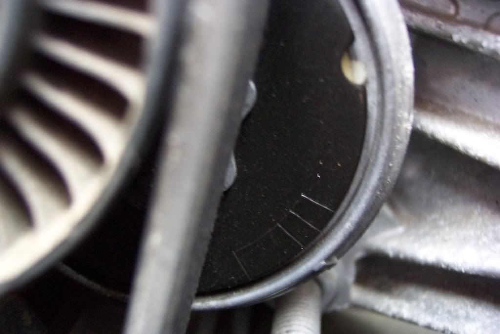

How about the tensioner?tavis
Is this tensioner adjusted correctly, or is it close enough??
Bert:tavis:

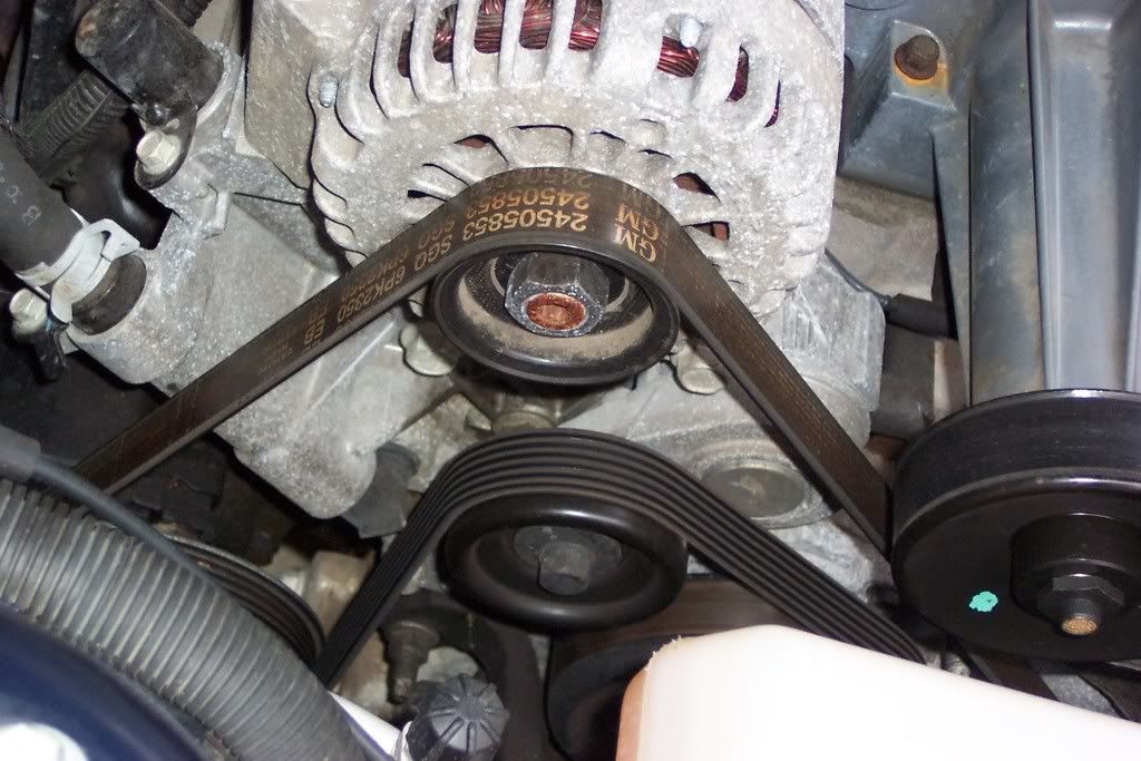

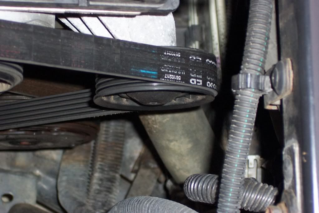

There is no way to answer your question from the pictures provided, except to say that with the printing still visible on those belt backs most likely they were changed at least once. And with the GM numbers on them, the change was at the dealer.
Look - all you need to do is look at the back of the belts and make sure there are no cuts or abrasions that fray or cut the fabric in the belt. You then need to look at the grooved side of the belts and count the breaks in the rubber. If there are no belts, great. If there is one break per inch, or so, plan to change the belts the next time you have service done like a state inspection or a tire rotation. Serpentine belts are designed to warn you by having the grooved face crack up VERY LONG before they fail. In my personal experience, I've run belts about a year after seeing that they had a crack or two per inch on the face. Actually, I think the thing to look for as a signal for 'change belts soon' is that there are bits of rubber missing out of the face (grooved side) of the belts.

Thanks Albertj, thumbsup they should be fine then. There are no cracks in the belts.
It is odd that the SC belt is black and the accessories belt is brown.

How do you read/interpret the lines on the pulley in relation to the notch on the housing?suspect
There are four lines that divide the "indicator" into four segments...
If tension is correct should the notch be aligned with the indicator line as shown in the attached pic?study

Actually, Bert, the different color belts - well, it's not odd. Most likely belts are different composition. There's Gates, Dayco, Goodyear, Ningbo (China), Bandu (Japan) and others. Replacement belts for just about every car on US roads are sold under the AC Delco name - I suspect they are from one or more suppliers (mostly Goodyear) but don't quote me on that 'cause I am only guessing. dunno
Watch out for the belts becoming noisy for no apparent reason. If that happens, check the pulleys (take belt off track at tensioner and turn pulleys by hand). If they do become noisy, they can't really be fixed so just replace them.
And that tensioner in your picture looks fine to me, the index ridge is in the middle of the 4 marks.

The back of the belt seems ok. You can't see the writing on the belts anymore. The tensioner mark is in the correct spot.
