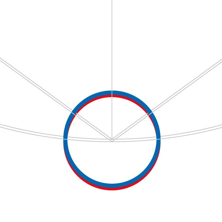

| i've heard of w-bodys using 5x114.3 rims just fine but please note that it is not recommended to use them under high hp applications and the wheels may not feel balanced on the car. (ie they balance fine on the machine, but when mounted on the car the .7mm difference allows movement or off center mounting.) I too am looking for some lightweight 17 or 18's come tax time b/c i need tires anyways. I would like the push the cornering, braking and speed to new levels but i dont want to go I/C just yet. So far i've found that the lighter the rim, the more expensive it will be. Also the racing rims scream "rice" to me, and that's not what i'm looking for. however at 17lbs for some 18's i may not car how they look anyone know the stock 12 spoke 16's weight for comparison? _________________ 1996 with 254k miles, L32 4" FWI -> ported N* -> Ported Gen V w/3.0" Pulley, Stage 3 Phenolic I/C, ZZP FMHE, 1.84 RR, Headers and 3" pipe to mufflers, F-body brakes, and lowered on Eibachs. -RIP AMG C400 White on black. Stage 2 w/E30 - 11.9@117 -daily | |

Cadillac people are having luck with the 5x114.3mm bolt pattern. Note the comments on bore diameter. Considering the added variety, I'm thinking it's worth a try. _________________ '05 GTO 6.0L • 6-spd • 95k miles • 0-60: 4.8s • 16.9 avg MPG • Nelson Ledges Lap: 1:26'95 Celica GT 2.2L • 5-spd • 165k miles • 0-60: yes'98 SC Riviera • 281k miles • 298 HP/370 TQ • 0-60: 5.79s • ET: 13.97 @ 99.28 • 4087 lb • 20.1 avg MPG • Nelson Ledges Lap: 1:30 3.4" pulley • AL104 plugs • 180º t-stat • FWI w/K&N • 1.9:1 rockers • OR pushrods • LS6 valve springs • SLP headers • ZZP fuel rails KYB GR2 struts • MaxAir shocks • Addco sway bars • UMI bushings • GM STB • Enkei 18" EV5s w/ Dunlop DZ101s • F-body calipers EBC bluestuff/Hawk HP plus • SS lines • Brembo slotted discs • DHP tuned • Aeroforce • Hidden Hitch^^^ SOLD ^^^ '70 Ninety-Eight Holiday Coupe 455cid • 116k miles^^^ SOLD ^^^ | |

| Personally, I wouldn't use a rim knowingly that was anything but 5x115. I know it's only .8 mm off, not very much, but still, off is off. Hubcentric rims may eliminate the issues, so make sure they are available if you go the 5x114.3/5x4.5 route. | |

| My past two sets have been 114.3 rims. And they work fine even under strong side loads. The only problem with them is that you need to tighten then at 3 intervals to get the proper torque. The guys at a tire store usually just use an impact and the lugs will come loose quickly or they shear off lugs. My wheels came loose once and have had 3 lugs sheared off this way. If I go to a tire shop now I always loosen and re-torque when I get home.
I usually tighten while the wheels are off the ground (which helps it center better) to about 70ft/lbs then lower it to tighten around 85ft/lbs finally 100ft/lbs the second time around. | |

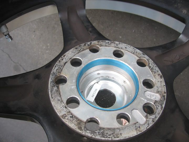

For everyone's reference, here is a site that sells hub-centric rings (aluminum or plastic) for a reasonable cost ($25-35): http://www.1010tires.com/hubrings.asp
The bore dia of our hubs 70.3 mm. _________________ '05 GTO 6.0L • 6-spd • 95k miles • 0-60: 4.8s • 16.9 avg MPG • Nelson Ledges Lap: 1:26'95 Celica GT 2.2L • 5-spd • 165k miles • 0-60: yes'98 SC Riviera • 281k miles • 298 HP/370 TQ • 0-60: 5.79s • ET: 13.97 @ 99.28 • 4087 lb • 20.1 avg MPG • Nelson Ledges Lap: 1:30 3.4" pulley • AL104 plugs • 180º t-stat • FWI w/K&N • 1.9:1 rockers • OR pushrods • LS6 valve springs • SLP headers • ZZP fuel rails KYB GR2 struts • MaxAir shocks • Addco sway bars • UMI bushings • GM STB • Enkei 18" EV5s w/ Dunlop DZ101s • F-body calipers EBC bluestuff/Hawk HP plus • SS lines • Brembo slotted discs • DHP tuned • Aeroforce • Hidden Hitch^^^ SOLD ^^^ '70 Ninety-Eight Holiday Coupe 455cid • 116k miles^^^ SOLD ^^^ | |

| Just a comment regarding the hub centering rings mentioned above. Make sure to measure them when you receive the order. Mine were supposed to fit the 72.62 mm bore diameter of my new wheels, but they felt loose, so I measured OD with a caliper at 72.05 mm, quite a bit off for a piece of turned aluminum dimensioned to 1/100 mm. They say 72.62 on the part.
The vendor mentioned above is being proactive so far, said they will measure a new set and ship out at no charge. I think it will be okay, but I wanted to give the heads-up to anyone ordering hub-centric rings: check 'em before mounting. _________________ '05 GTO 6.0L • 6-spd • 95k miles • 0-60: 4.8s • 16.9 avg MPG • Nelson Ledges Lap: 1:26'95 Celica GT 2.2L • 5-spd • 165k miles • 0-60: yes'98 SC Riviera • 281k miles • 298 HP/370 TQ • 0-60: 5.79s • ET: 13.97 @ 99.28 • 4087 lb • 20.1 avg MPG • Nelson Ledges Lap: 1:30 3.4" pulley • AL104 plugs • 180º t-stat • FWI w/K&N • 1.9:1 rockers • OR pushrods • LS6 valve springs • SLP headers • ZZP fuel rails KYB GR2 struts • MaxAir shocks • Addco sway bars • UMI bushings • GM STB • Enkei 18" EV5s w/ Dunlop DZ101s • F-body calipers EBC bluestuff/Hawk HP plus • SS lines • Brembo slotted discs • DHP tuned • Aeroforce • Hidden Hitch^^^ SOLD ^^^ '70 Ninety-Eight Holiday Coupe 455cid • 116k miles^^^ SOLD ^^^ | |

| First vendor could not locate a correct set of aluminum rings, so I bought them from a seller on eBay, Discount Tire Direct. This order was near half the price and took 1/3 the time. Most importantly, the new rings are the correct size! Here is a pic of the ring inserted. A correct fitment is tight, requiring you tap it in with a small hammer. The ring should press in flush with the hub mounting surface of the wheel: They bolted up without any problems. I used a torque wrench to cross-tighten them at 3, 5, 10,15, 25, 35, 45, 55, 65, and 75 lb-ft. Maybe a overkill, but I wanted to give these rims every chance to be exactly centered. With all 4 new wheels on, there is absolutely no vibration whatsoever. In fact, they ride smoother than my stock 5x115 wheels ever did. The guy at 1010Tires told me it wouldn't work, but I am quite happy with the result. Just use the hub centric rings, torque them on carefully, and 5x114.3 (5x4.5") bolt pattern wheels will work fine with 5x115 hubs. _________________ '05 GTO 6.0L • 6-spd • 95k miles • 0-60: 4.8s • 16.9 avg MPG • Nelson Ledges Lap: 1:26'95 Celica GT 2.2L • 5-spd • 165k miles • 0-60: yes'98 SC Riviera • 281k miles • 298 HP/370 TQ • 0-60: 5.79s • ET: 13.97 @ 99.28 • 4087 lb • 20.1 avg MPG • Nelson Ledges Lap: 1:30 3.4" pulley • AL104 plugs • 180º t-stat • FWI w/K&N • 1.9:1 rockers • OR pushrods • LS6 valve springs • SLP headers • ZZP fuel rails KYB GR2 struts • MaxAir shocks • Addco sway bars • UMI bushings • GM STB • Enkei 18" EV5s w/ Dunlop DZ101s • F-body calipers EBC bluestuff/Hawk HP plus • SS lines • Brembo slotted discs • DHP tuned • Aeroforce • Hidden Hitch^^^ SOLD ^^^ '70 Ninety-Eight Holiday Coupe 455cid • 116k miles^^^ SOLD ^^^ | |

| - AA wrote:
- With all 4 new wheels on, there is absolutely no vibration whatsoever. In fact, they ride smoother than my stock 5x115 wheels ever did. The guy at 1010Tires told me it wouldn't work, but I am quite happy with the result. Just use the hub centric rings, torque them on carefully, and 5x114.3 (5x4.5") bolt pattern wheels will work fine with 5x115 hubs.
Thanks for the pics and info. When you say you have absolutely NO vibration whatsoever, do you mean not any at all. That's a pretty strong statement to a guy that has chased even the smallest to the noticeable and back to small and still annoying vibration since I bought this car. If you found the magic Bullet, Ill drive to you and buy this setup for twice what you paid for it, maybe. | |
