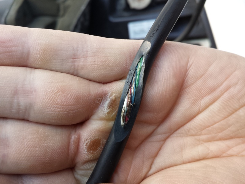

So this is how I made my entrance from the engine bay to the cabin..
Firewall wiring port - getting stuff into the cabin Img_2010
No idea how this happened. Wide band cable got a nasty cut.
Firewall wiring port - getting stuff into the cabin Img_2011
Wasn't really a problem because I had to cut the cable to get it into the cabin and rewired the plug once it was inside.
Firewall wiring port - getting stuff into the cabin Img_2012
