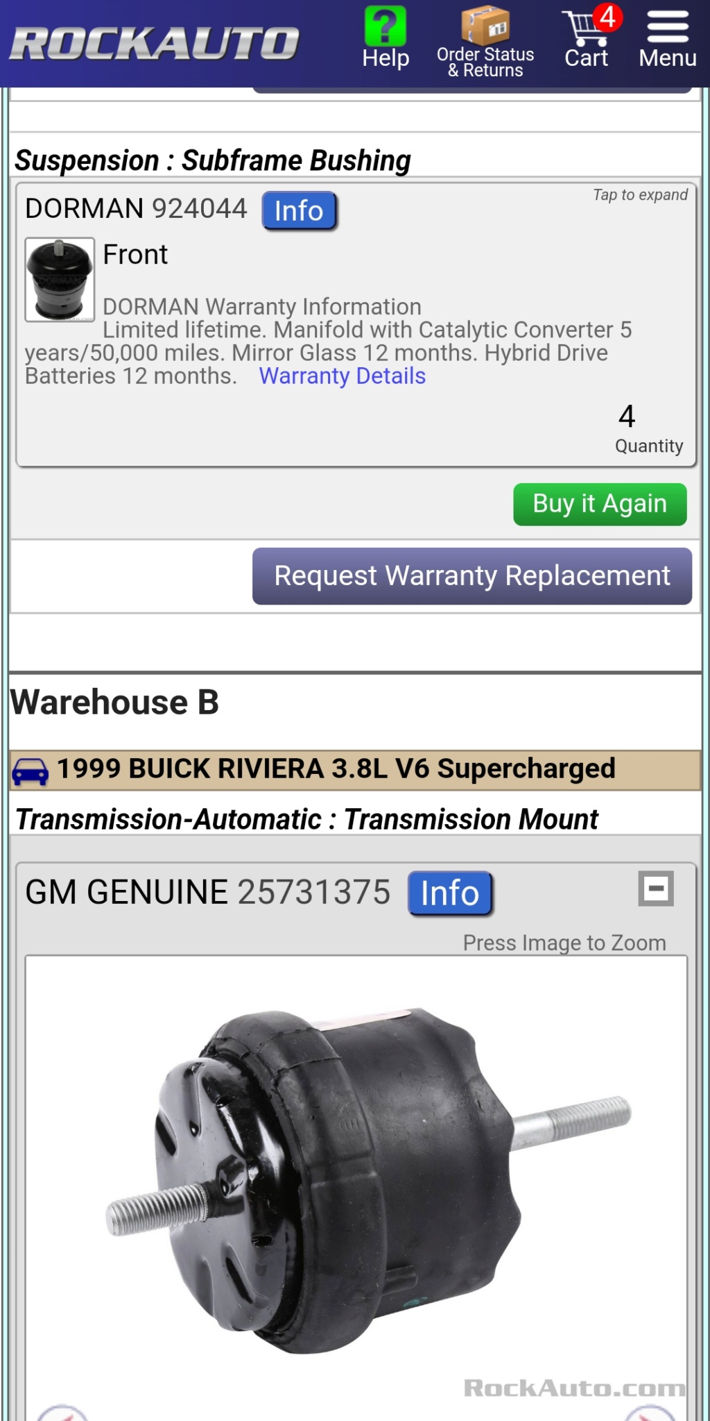

[ pimp url=https://servimg.com/view/20169161/17]motor mount - What do we do for motor mounts now? Screen12[/url]
I bought this a long time ago.
