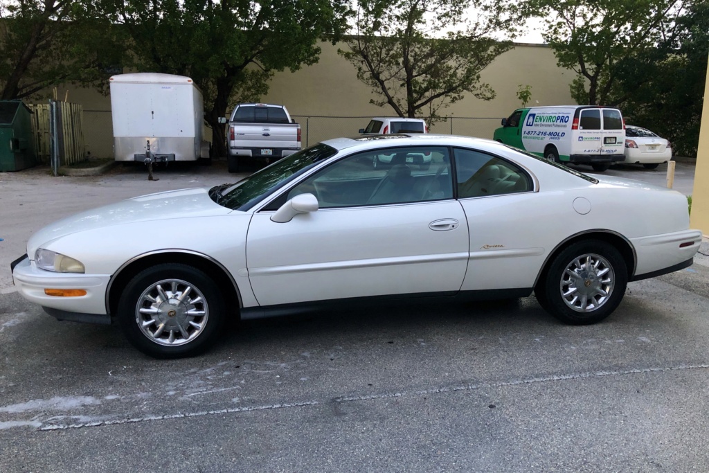

Hello all. What are you guys doing about the yellow cornering lamps on your cars? My 99 is in excellent shape with the exception of the yellowed cornering lamps. Really bothers me.
I see GM still has the cornering lamps available for the 95-96, but the 97-99's are long discontinued. I wish someone made an aftermarket reproduction.
Can the 95-96's be adapted to fit the 99's? I'm wondering what's different on them? The housing, the lens, or both? I'm wondering if I could get new 95-96 lamps, then possibly dissect then lens and adapt to my current 99 cornering lamp housings?

Here's a pic of my car.
Cornering Lamps 99_riv10
