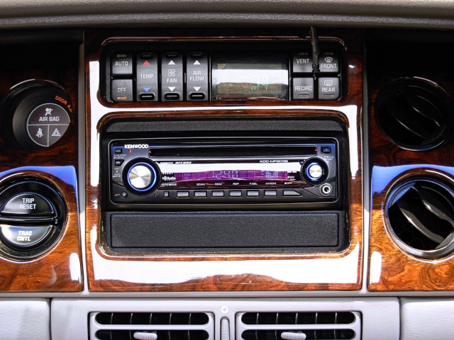

PostSubject: Aftermarket Head Unit Install?   Aftermarket Head Unit Install? EmptyThu Dec 13, 2007 7:38 pm
Looking to install and aftermarket head unit and was wondering if anyone has used the Scosche GM1583B kit or something similar. How did it fit, look, etc. Thanks
PostSubject: Re: Aftermarket Head Unit Install?   Aftermarket Head Unit Install? EmptyThu Dec 13, 2007 8:43 pm
i dont think that kit will work b/c of the shelf. you need a lot of room for the wire harness.
my kit fits well, but i dont know what the part # is. just a gm kit for buicks with a block off plat on the bottom half. the rivs head unit depth is very shallow so you may have a problem fitting the dash back over the new unit, or you can cut away some of the plastic at the rear of the deck.
are you getting a PAC SWI-x too?
Aftermarket Head Unit Install? Dsc_0110
PostSubject: Re: Aftermarket Head Unit Install?   Aftermarket Head Unit Install? EmptyThu Dec 13, 2007 9:06 pm
i havent used one on the riv but i had one on my stratus coupe, and it was a great fit
PostSubject: Re: Aftermarket Head Unit Install?   Aftermarket Head Unit Install? EmptyThu Dec 13, 2007 9:33 pm
that looks like the same kit I had before I had my EQ. Actually that one has a raised face plane. Mine was just flat. But anyway, it mounts fine. Matthew, does your kit set the head unit forward from the dash?
Like Matthew said, I would just cut the plastic out from behind the head unit area to give some more freedom. If you do that, you should have no trouble at all using the flush mount kit like that.
Before I had the EQ and all the extra wiring, I was still able to mount it flush without cutting the plastic but it's definitely worth it to cut that booger.
PostSubject: Re: Aftermarket Head Unit Install?   Aftermarket Head Unit Install? EmptyThu Dec 13, 2007 9:41 pm
a picture is worth a .... well its just easier to show than tell happy
Aftermarket Head Unit Install? Dscn0410
FWIW i had more fitment problem with my old alpine than i do with the new
kenwood, so maybe they are making them smaller than they used to? or it
could just be manufacturer differences. eihter way, there is really no way to know how it will fit until you get it in there. but it shouldnt be anything major.
