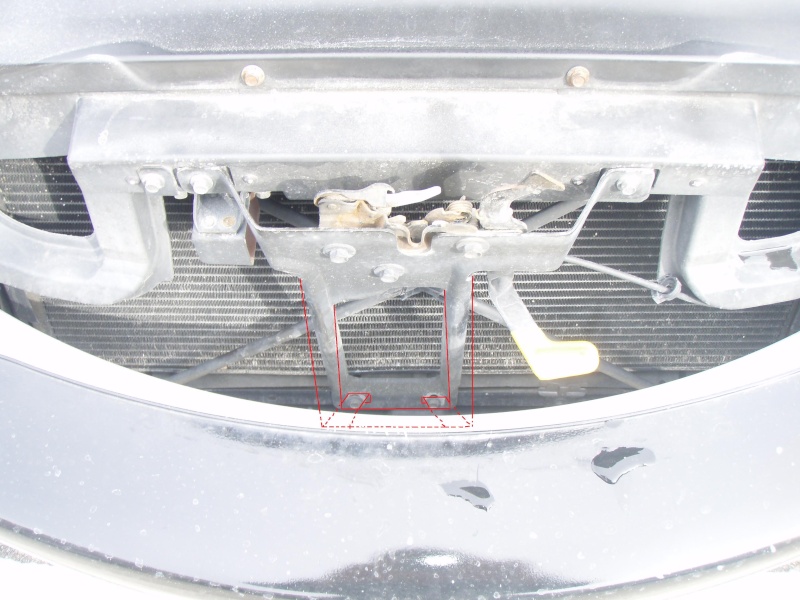

eric that picture you showed is more of a turbo intercooler, or for a side-mounted supercharger. You need a path to get air from the S/C into that exchanger, then back to the intake manifold. You could use an exchanger like that if you put on an L36 LIM and a side-mounted S/C but it's kind of impractical.
alex, if you do go turbo you'll need to worry about where to put your intercooler core. Our front bumper is certainly a challenging location.
eric, if you use a more standard w-body style heat exchanger (somebody had one with two small coolers on either side of the hood latch, intense maybe?) it's much narrower so you can fit it in front of the radiator with some creative bracket fabbing.
im not worried about it, by the time im ready to twin turbo, ill have my custom air dam built
