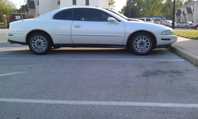

No, not ride height. Weight distribution. Before I was like this / now I am like this \.
 I am most definitely seeing an improvement in MPGs, power, and traction. Before the new springs, my weight was dumped in the back. Now I have it back where it needs to be up front.
I never got MPGs like this before. My driving style has only become more aggressive. So figure that one out. It is for sure the weight distribution.

Power and traction, sure. Handling, sure. Weight distribution can make differences there. But MPG doesn't care where your weight is at, it only cares how much weight you have. Shedding weight is what matters; moving weight - not so much for MPG.
To compare, I've spent most of the time I've owned the Riv moving weight to the rear, because I believe that's the ideal way to carry weight in a car. For example, removing weight from the engine bay and front suspension, and adding heavier things like stereo equipment and trailer hitch receiver to the rear. All of this moves away from the OEM 70/30ish distribution and closer to 60/40. I've kept very (very) accurate fuel logs for many years now, and can see what makes a difference and what doesn't. The weight shift didn't matter even a slight bit, and I've shifted about 100 lb so far.
Your aggressive driving style creating better MPG could be real, or it could be imaginary. If by "aggressive" you are taking lots of hard corners so the need to brake and accelerate is less, then yes I can buy it. If by aggressive you mean more acceleration and braking than usual, then no it's not giving you any better MPG. Even if the change in weight distribution from your new springs were helping a little, it would be so miniscule compared to the huge loss from accelerating and braking that you would see effectively lower MPG in the end. There must be some other factor at work here. Need to do some controlled tests to know anything beyond a guess.

That's all fine and dandy. But this is real.
This is how you get poor MPGs
FAQ: Improving Bad Gas Mileage - Page 7 IMAG0512
This is how you get better MPGs
FAQ: Improving Bad Gas Mileage - Page 7 Imag1015
I track my MPGs and miles per fill. Numbers dont lie.

Drive around without your center caps? I've never tried that scratch
FAQ: Improving Bad Gas Mileage - Page 7 Empty
PostSubject: Re: FAQ: Improving Bad Gas Mileage   FAQ: Improving Bad Gas Mileage - Page 7 EmptyThu Jun 13, 2013 10:47 am
I knew you were going to say that..
AA, think about it. If it affects traction, acceleration, etc.. its going to affect MPGs. The power is being put to use and not being wasted like it was when the weight was tipped in the back.
It's not even something I need to wonder why. The numbers done lie. My fuel economy has increased. The end.
