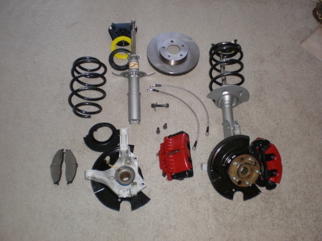

i finally got all my parts together!
here is what i have (everything is new, save for the calipers and knuckles):
2 KYB GR-2 struts from a '98
2 fbody dual piston aluminum calipers (fully rebuilt)
set of morse brake pads
2 rotors (Chinese no )
2 1997 front spindles with hub bearings
2 zzp 20.5 inch SS brake lines
3 bottles of DOT4 synthetic brake fluid
2 Moog strut top mounts
4 Moog spring insulators (2 top/2 bottom)
2 Moog strut bearings
4 Eibach ProLower STS springs (rear is already in)
2 camber bolts
misc hardware (cc washers, bolts, etc)
i will be reusing the strut bumps and dust cover. and the upper isolator (if it fits)
hopefully i wont run into any problems or areas where things dont fit up.
this is only the 3rd time, that i am aware of, someone has done a front end conversion on a 95/96 to newer 97+ stuff.
if anyone needs anything off my old setup i'd be happy to part out happy this setup is costing me over $1000 but it should be worth it to have new suspension on all 4 corners, and great brakes.
here is a pic of all the stuff before it gets installed next Sunday! (29th)
Write-Up: 1996 to 1998 Front Suspension Swap w/F-Body Brakes P3190011
i will be taking lots of picture along the way in case of a write-up.
Write-Up: 1996 to 1998 Front Suspension Swap w/F-Body Brakes Dsc_0110

Good luck! you will really enjoy the change in your ride.
I did notice on thing the strut top mounts are they 97 or 98? because I think the 98 have a plastic tab on them and I think that won't work with the 96 as that whole for that tab is not there. I used 97 strut mounts.
Also do you have the spindle to Caliper bracket bolts?
Write-Up: 1996 to 1998 Front Suspension Swap w/F-Body Brakes Empty
PostSubject: Re: Write-Up: 1996 to 1998 Front Suspension Swap w/F-Body Brakes   Write-Up: 1996 to 1998 Front Suspension Swap w/F-Body Brakes EmptyFri Mar 20, 2009 11:34 am
i got 98 top mounts frown
can i just cut the plastic tabs off? provided all the holes line up the same.
and yes i have the caliper bracket bolts.

97+ hubs/wheel bearings. The "new" knuckles don't have them and I would probably destroy the OEM ones if I tried taking them out.
98-02 F-body calipers.
SS brake lines (already installed).
Outer tie rod ends because for the price of replacing a blown boot you can just replace the whole tie rod.
Oi, this better be worth it. The knuckles and control arms will be getting the same blaaaaaack treatment that the calipers got. Anyone think I should do the ball joints while I'm in there? The plan is to do everything up and then just throw it on as an assembly this weekend or next depending on when parts arrive.
Everything was bought new with the exception of the calipers and knuckles.

Its been a long time since i did this mod, but I dont know for certain if the 96 struts will bolt up to the 97+ knuckles. I think the holes and width of the mount point is different.
If it were me doing it, i would order the strut/spring combo kit from rockauto and be done with it.
Also, be careful with the cheapo tie rod ends (deeza and off names) I have used them on 2 occasions and they failed in a short amount of time (2 yrs or less). Id stick with the delco replacements even though they are a bit pricier, i hate doing the work twice.
Another thing you will need are the caliper bolt inserts from McMaster -carr. the fbody write up should have the part # listed.

PostSubject: Re: Write-Up: 1996 to 1998 Front Suspension Swap w/F-Body Brakes   Write-Up: 1996 to 1998 Front Suspension Swap w/F-Body Brakes EmptyWed Jun 11, 2014 8:45 am
Don't use insert sleaves to mount your calipers - you'll regret it after 5k miles or so. See warnings about this in the f-body brake thread.
Also, aren't lower ball joints included with new control arms?
I was going to drop the caliper brackets off today or tomorrow to be tapped out, don't worry.
I'm not getting new control arms, just painting the stock ones to clean them up.

Lower ball joints are included with new LCA's but if you are not replacing them i wouldnt worry too much about it. Ours seem pretty robust and even at 200k miles when i did one of mine i didnt feel any play in the old one.
As for the sleeves, ive had the original sleeves on mine since the day the fbody's went on, almost 100k miles and a least 4 rotor/pad changes and i havent had a problem with them.
I suppose the "right" way is the way mentioned in the warning thread, but that not to say the sleeves dont work for some either.
I checked the bolt holes from my stock struts to the new ones I have for 97+ and they seemed to line up perfectly. I'll go out and measure again today or tomorrow to be sure though.
People have had issues with the combo kit sitting to high (namely Charlie). That and I wanted to get the STS lowering kit or F41 or FE3 springs.
