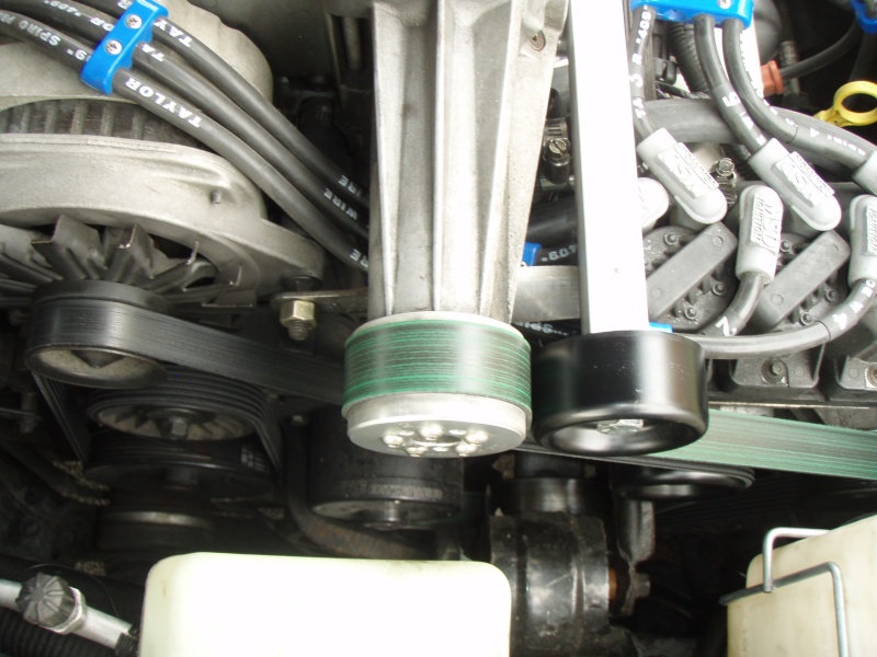

I ran into a problem
8rib balancer's on. Mount didn't drive me too crazy. Oh wait I spoke too soon. The lower idler pulley in 8rib touches the motor mount bracket. What now?
Photobucket
Photobucket
Ewolfe, what did you do here??

I can't remember right off hand, it was done last year. I know there wasn't any grinding involved. I tried going out to my garage to check but my key doesn't work and the garage door opener is over at my parent's place inside my Bronco. I will stop by their place this afternoon to grab it and let you know how much room I have with my pulley. With all the photos I have, I can't find one good one that shows the 8rib tensioner either. You should have plenty of room looking at some of my other photos with the OEM pulley on. Call Paul 317-436-4004

found a photo but not a very good one. At first I though I might have used the original because its almost wide engough but that wasn't the case. My idler is not a plastic one like the one you have but a metal one instead. Paul should have the PN.
FAQ: Serpentine Belts - Brands and Types - Page 2 P7250310

The lower idler in your picture looks like the original 6rib width. I'm thinking that's the way it's gotta be but I'll check with Paul. My S/C idler pulleys are all metal. The only pulley that's plastic is the accessory belt tensioner. The original pulley has a little extra edge room so I guess it wouldn't be too bad.

Ok I've got the solution and I couldn't have prayed for a more perfect one. The answer is 38033 by Gates!
Photobucket
Photobucket
All 90mm pulleys - The left one is the stock lower idler pulley (6rib). The right pulley is an 8rib (that doesn't fit under the motor mount bracket) The middle one is a compromise. It might be for a 7rib belt but I didn't check the actual application. It does fit under the bracket though, barely and it also lets you use the crazy OEM bolt with the giant flange and built in shank, unlike the 8rib.

Photobucket
Photobucket
That's the 8rib belt on the 38033 pulley - looks fine to me
Photobucket
That's ZZP's powerbond 8rib balancer - no problems with that.
Photobucket
Photobucket
Looks like the 716 belt is the one. Along with the 3" and 3.5" tensioner and grooved idler pulleys, it handles the 3.2-2.8 S/C pullies beautifully.
That half inch or inch in my case goes a pretty long way for the belt.
