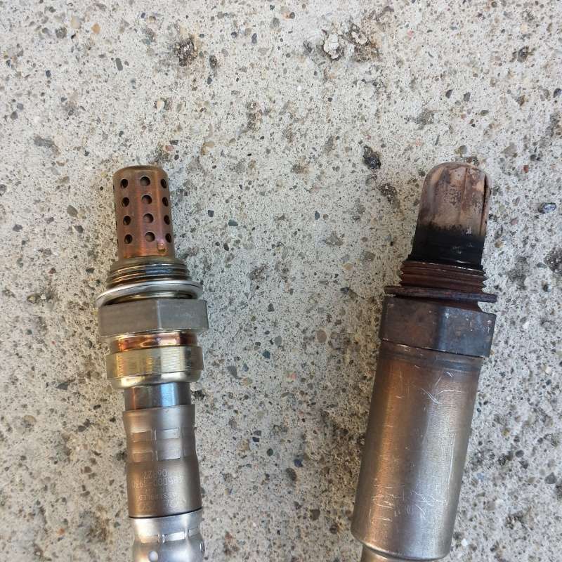

PostSubject: Re: FAQ: O2 (Oxygen) Sensor Information   FAQ: O2 (Oxygen) Sensor Information - Page 5 EmptyMon Jan 05, 2015 12:38 pm
For future reference, an O2 sensor socket is a very specific tool - a deep socket with an opening on one side for the wires to slide through. If you don't have one, rent or borrow one for the job (most autozones etc have 'loaner tools' that include this socket).
Also, if the old one is really really stuck, PB blaster is a great penetrant, and making the bung glow orange with a torch will help. Don't heat up the sensor, heat up the bung it's screwed into.

I have one I got at Advance Auto and it was good for loosening one sensor, one time. Now it's only good for tightening them. If you try to loosen with it now, the socket just spreads apart and gets jammed on the sensor. That's probably why you can't find a good one.

Checking Amazon for an oxygen sensor socket I find nothing but poor reviews and/or low review counts.
Anyone have a lead on a known socket that will be perfect for our sensors?
Thank you
9 times out of 10, we have to heat the O2 up with a torch before it'll come loose...even with a socket. I have GM's "J-Tool" O2 socket, and it spreads apart just the same.
If there's room, I'll just use a 24mm open-end wrench with a another wrench "attached" to it for more leverage. That works the best if there's room.
I also have a super-thick O2 socket that doesn't flex apart, but it's only a 3/8" drive....

Apply PB blaster 2 hours ahead. Slip a box wrench over sensor, use additional wrench for leverage. Apply heat to bung if necessary.
(this has already been covered in the thread by various members, but this is how I broke mine loose)
