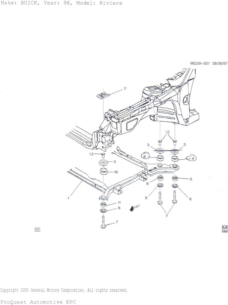

im not really sure what they are called, but the last time my car was up on a lift i noticed the orange rubber bushings on the rear part of the sub frame/ engine cradle are dry rotted and falling apart.
parts # 8 and 4 i believe.
Write-Up: Subframe/Cradle Mount Insulators & Bushings Cradle10
are these extremely difficult to replace? the dealership has them for $8 each and i think there are 4 in the rear of the cradle and 2 in front. what are they for? will it hurt anything if i dont replace them?
TIA

I think these are more of a body mount and should be fairly easy to replace. I think once you try to replace that one piece you will see that the washers and bolts will need to be replaced as well. Before you get into it, I would check to see if the dealership has a complete kit or how much all components would cost if needed replaced.

I wouldnt think they would use rubber to center the cradle bolt holes,if so then the cradle would float,which cant happen... probably ther for vibrations.....the bolts should be fine unless they come out hard or something... shouldnt be hard to replace as long as you can drop the cradle just enought to slip the new ones in..an loctite an torque to spec..

PostSubject: Re: Write-Up: Subframe/Cradle Mount Insulators & Bushings   Write-Up: Subframe/Cradle Mount Insulators & Bushings EmptyWed Jul 02, 2008 1:00 am
here is the dealer pic :
https://rivperformance.editboard.com/series-ii-engine-transmission-f4/cradle-mount-bushings-t1897.htm?highlight=bushings
