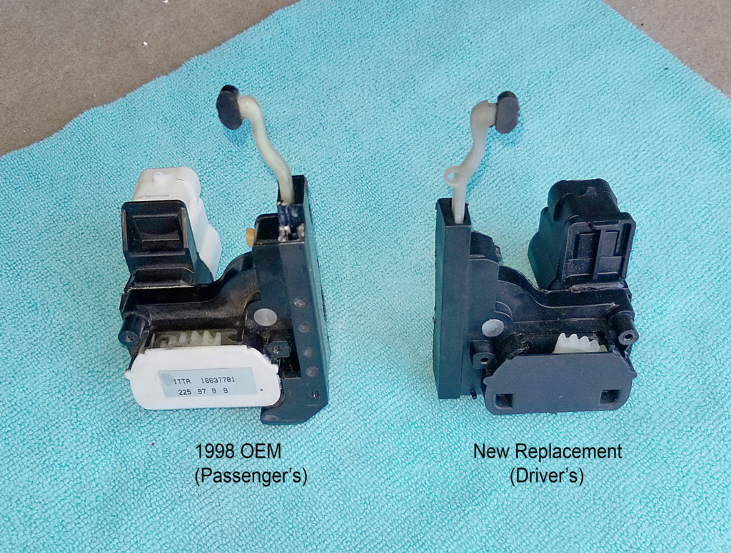

FAQ: Power Door Lock Problems - Page 5 Empty
PostSubject: Updated latch and lock actuator question    FAQ: Power Door Lock Problems - Page 5 EmptySat Jul 10, 2021 3:32 pm
jimmyriv wrote:
My drivers door won't unlock with the key fob or the switch. I hit the power locks sometimes when parking knowing the lock doesn't work. I figure the alarm will work anyway, then if I forget and grab the door handle I set it off. (dumb) bonk
Sounds like you need to replace the latch unit.  It's a little tight in there but not too tough.  I did one on my car (pass side) when it failed and had dealer's boy shop do the other when it failed. The new ones were a little different, I suspect it's a one-time replacement.
I have a problem with replacing the door lock actuators on my '98 Riv.
I can't get the same OEM actuators that have failed, and the new ones do not fit.(reference photos here)
FAQ: Power Door Lock Problems - Page 5 Actuat11
FAQ: Power Door Lock Problems - Page 5 Actuat10
The dealer told me I need to get an upgraded latch assembly. There is one RH unit available new for $400+. The LH unit is not available new, and the cost of either is a budget buster, anyway. This unit is supposed to work with the newer actuators. He said '97-'99 Riv or Aurora latches that have anti-theft feature RPO code UA6 would work.
Problem is, I how can I tell the difference between those latches I have and any I might seek without numbers a salvage guy could use? That is, I need part numbers for both, I guess.
An alternative might be to rebuild the OEM actuators I have?
There is a thread from about 10 years back where Nigel talked about grafting old and replacement actuators together, here:
https://rivperformance.editboard.com/t8752p50-faq-power-door-lock-problems?highlight=door+lock
The thread ends without a clear explanation of how to do this.
My car was sitting for about 9 years, so it's possible they aren't worn out, but need some attention.
Anyone recall this thread, or know how to renew an old actuator?
Any advice welcome as how to proceed.
denim
denim
Location : Albany, NY
Joined : 2011-08-27
Post Count : 923
Merit : 33
PostSubject: Re: FAQ: Power Door Lock Problems   FAQ: Power Door Lock Problems - Page 5 EmptySun Jul 11, 2021 3:06 pm
Okay, maybe someone can tell me which terminals on the door actuators I can apply power to in order to test them? I have service manuals, but limited automotive electrical knowledge.
I found a service that will rebuild the actuator, which seems not-too-hard, but need to be sure they are the actual problem with the locking system.
Thanks!
